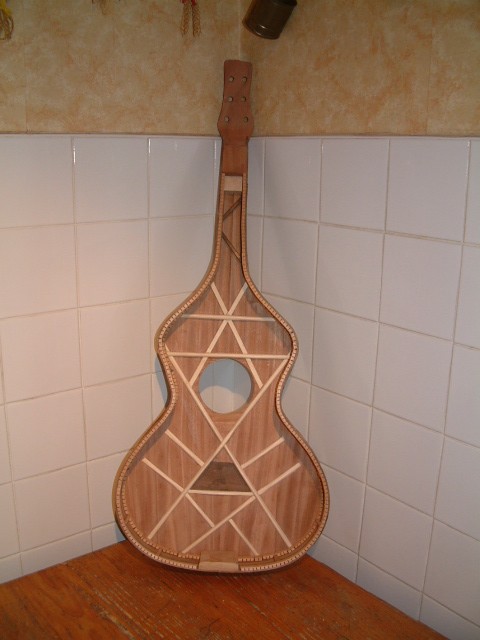

My Weissenborn-style hollow neck lap slide is finished and I decided to call it Red Kite after the majestic birds that I see around my workshop every day. I’ve had the most fun for a long time in building this one. I feel excited but at the same time daunted. I’ve played guitar for 40+ years and when I string them up I can usually play them pretty well and put them through their paces. I’ve only dabbled with slide though so it’s like going back 40 years and being a complete learner again – the nearest I’ve come is when I started playing bouzoukis and citterns. This is going to be my “playing development” for the next year or so and it’s going to be a gas. I’ve done a couple of sound clips. For the first I decided to do what I normally do when stuck and puzzled – put the instrument in DADGAD and play what I hear in my head, so this is called Red Kites to go with the guitar and give a feel for the sight and sound of these wonderful majestic birds. There’s lots of clunking with the bar slide and missed intonation and damping but it gives a flavour of the guitar:

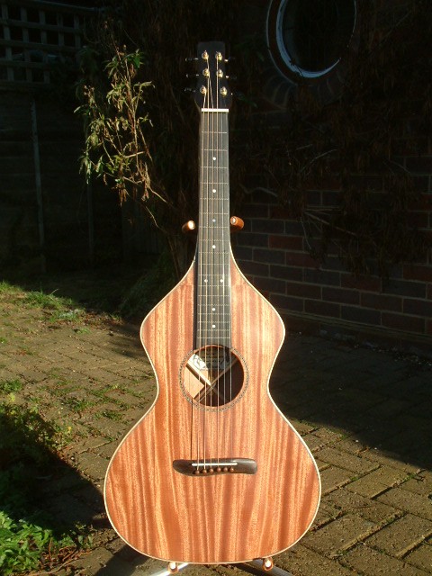

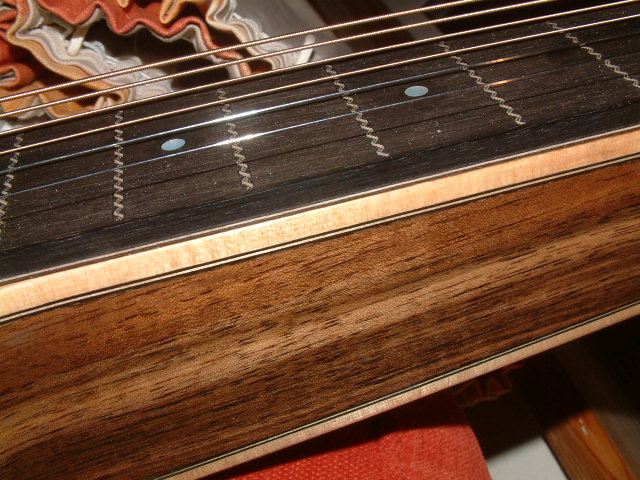

Now for some pictures. The top and back are both 4 piece Sapele, the sides are English walnut, the binding is Lutz spruce that Shane Neifer made up for me, the headstock veneer and bridge are Old Rio Rosewood, snakewood bridgepins, ebony fingerboard with rope fret markers, mini Gotoh tuners with ebony buttons. The finish is 4-5 coats of pre-catalysed lacquer over Z-poxy rubbed back to a natural finish.
Front:

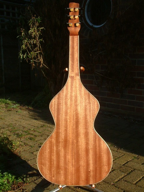

Back:

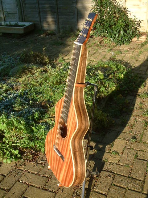

Side:

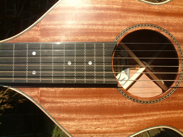

Fingerboard with rope fret markers:

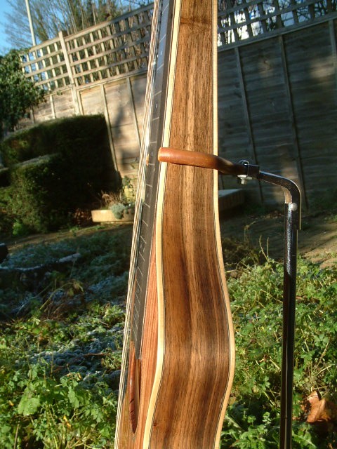

A closer look at the binding:

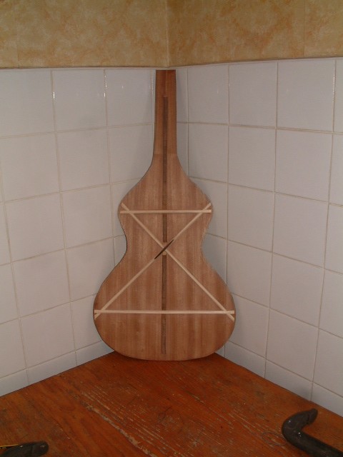

Front bracing:
Back bracing:

Dave,
She turned out awesome! The shape is classic! And she sings sweet! It is hard to see in these pics but did the curl show up in the bindings?

Thanks all,
Shane,
There is definitely curl in the bindings but it is hard to photograph. This is my best attempt so far:
I love the look and effect they give. The main thing I learned using them is that next time I will remember to shellac them before doing the dry runs to make sure of the fit - the brown tape took it's toll a bit on them as happens with tops.

Man Dave, I just noticed more details! No frets, just an awesome inlay at each fret location, you really 'did 'er up' for a prototype!

Shane - it really was built from bits and pieces from the workshop apart from your lovely bindings. The frets were one length of gorgeous rope purfling (made in Germany I believe which is appropriate) left over from the baritone I made for myself. Looks like I'll have to get some ordinary size lutz tops from you as well before George Lowden buys them all

Todd - I'm not really a "plans" person and made up my own design around - more or less - the standard Weissenborn dimensions. I gather that Stew Mac sells a plan and that there is one on the MIMF. I'd be happy to give you any info on the dimensions I used (the bracing pattern you can see from the photos) and the detailed build is photo documented on my website under "Current Projects". pm or e-mail me if you have any questions.Dave White39071.782337963

Dave--one more thing:
I really like the rope purfling fret markers.
So much so, that I'd like the name of that design and the manufacturer's info, if possible.

Did I mention that it looks good? A hardwood top with softwood bindings--who'da thought?
