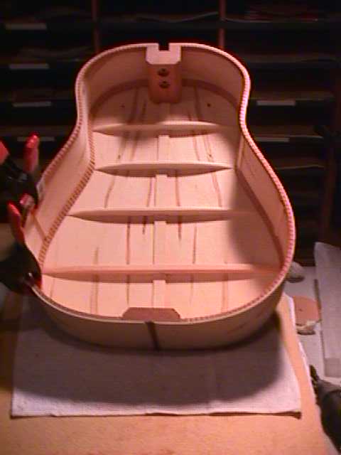

Inside the Box

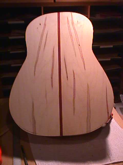

A look at the back

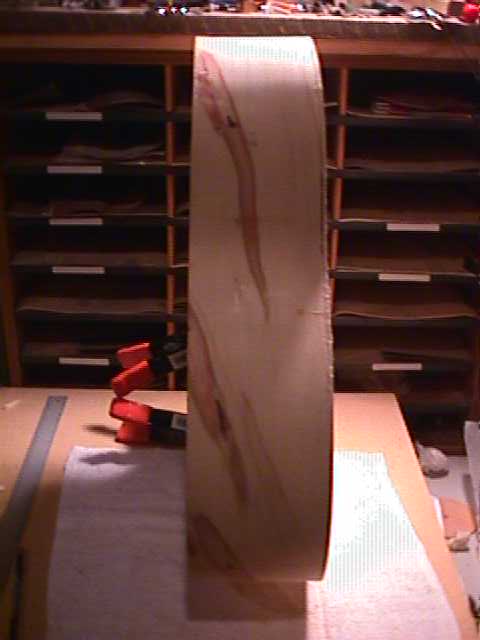

Side profile

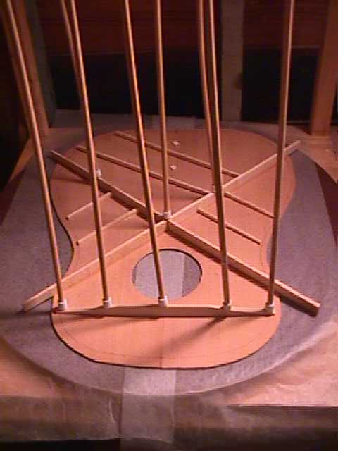

Here is the WRC Top on the Deck ready for final carving and shaping before it gets glued. This one has a Spalted Maple Rosette bordered inside and out with BWRWB purflings.

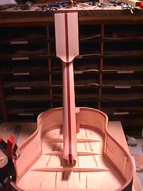

And finally the Neck with the Bloodwood Lam
