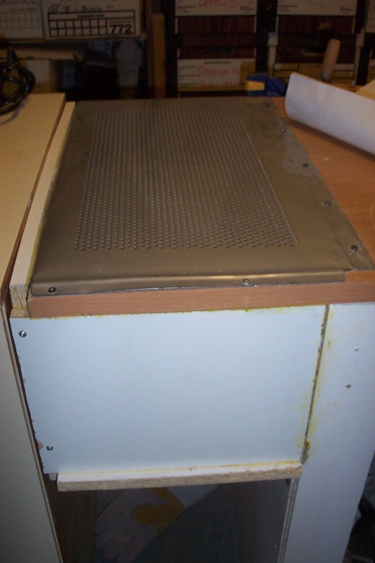

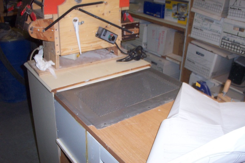

There you go folks, at the request of my great Pals Ron, Hesh and Billy, here are the pics of what i built, it's made of melamine slides for the dust chute, the grid or screen? is a recycled thing i scrounged somewhere around here, the holes are ~ 1/8" or less in size so they might be too small for an efficient vacuuming effect, i'd really love to hear thoughts and experience on that!TIA

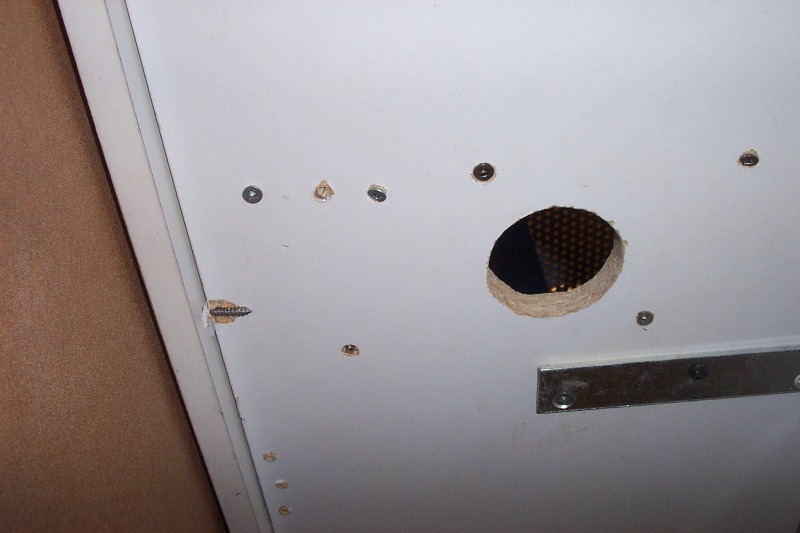

a view from underneath, i think i screwed up there!
In this pic, you can see that i added some plastic blue sheets to help the dust find it's way to the vacuum hose, it also has 2 melamine planks or boards disposed in a "V" in there as well, under the plastic sheets, if i make any sense! here it is:

It's my understanding brother Hesh that a downdraft table should be hooked up to a powerfull enough DC with sufficient CFM (most I would think will require 500-700 cfm, for a small home use one that is) and that they should suck down all of the dust.
This is just my understanding from what I've read. I don't have one, but it would be nice one day.
Of course, take a read over at Bill Penz's site on downdraft tables, it has a very good chart for CFM requirements per table size.

Thanks Hesh, will give that a read tomorrow since it's getting late for me tonight, thanks bro!
I forgot to check how many CFMs my shop vac does, will check the specs tomorrow also, and thanks for the pad advice!

Merci Andy mon copain de la lutherie Californienne! , maybe we should all take a look at the link Hesh and Rod posted last night, my DT looks cute but might not be efficient enough tho, will read those texts today and see what adjustments i must make if any!

Thanks guys for the info. I should deffinatly build one of these! Serge,I think our shop vacs aren't enough.I have been looking at some of Grizzlys DC's.

I have no experience with a downdraft table but when I toured Santa Cruz Guitar Co. I was surprised by how big the holes were in their downdraft table (don't remember exaactly about 3/4" to 1") so I asked about it. They told me that they use to have a top w/ smaller holes but it didn't have enough suction so they went to the bigger holes and that increased the suction.
PostPosted: Mon Nov 20, 2006 5:06 am
Thanks for the link Dave , will look into that, i think Reno-depot sells this DC in Gatineau, will check that up! Thanks!
Great input Roy, will take that into account, thanks to you as well!

I like the idea of an auxilary fan right under the table, that should increase CFM substantially! By using a squirrel cage do you have to clean the cage very much from dust?
Good idea Serge without any windows air quality is important!

That looks really nice, Serge. Let us know how well it performs. Thanks for posting the photos.
PostPosted: Mon Nov 20, 2006 10:02 am
Thanks Billy and Ron, i will probably save money and buy me a DC to go along with it and enlarge the cavities, sounds like the way to go after reading what Hesh has posted.
