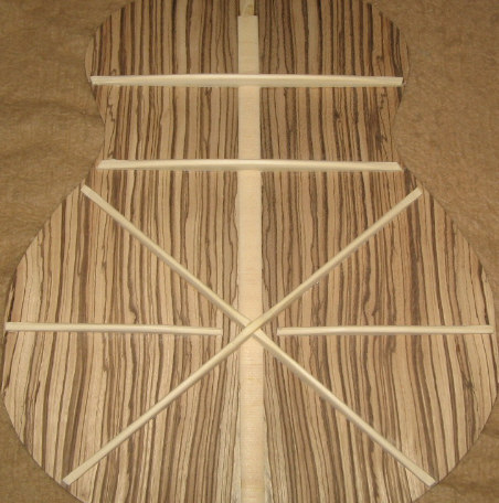

Hello all. I'm getting ready to brace the back of my cocobolo-Engelmann
small jumbo, and I'm interested in a cross braced lower bout for the back.
I'm of the "let the back vibrate in sympathy with the top" school of back
bracing, so keep that in mind. I've seen pictures somewhere of a cross
braced back - I think it was here, but quite some time ago. So show me your
backs! (x-braced, that is)

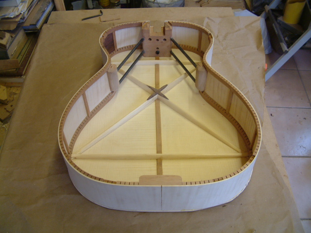

How about this...it is of my 2nd guitar. It is way over braced, but this gives you an idea. Good luck!

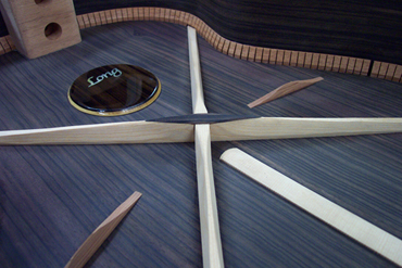

Crazytooguy I hope this helps. This my SJ design other wise know as the OLF SJ. This bracing pattern is on the OLF SJ Plans available from The OLF Library of Plans. The Snake wood cap was specific for this client
You will notice it is six sided star rather than just an X. this is to help support the extreme edges of the back at the apex of the lower bouts dome from wanting to flatten out.

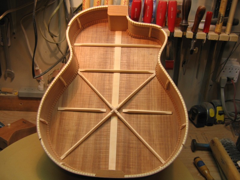

Here is my current build.
Similiar to Michaels but maybe a bit lighter. The cap is one piece maple shaped to an 'x' in place.

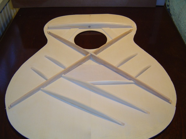

You've all seen this pic before but this is how I do my backs.

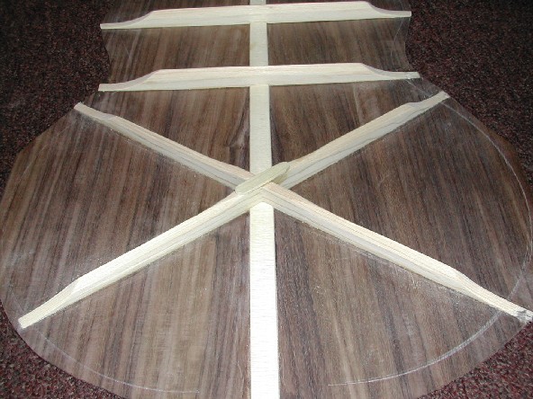

Here's more grist for the mill. Still needs final sanding, but very close to the final dimensions. X-braces are 3/4" tall at the center.

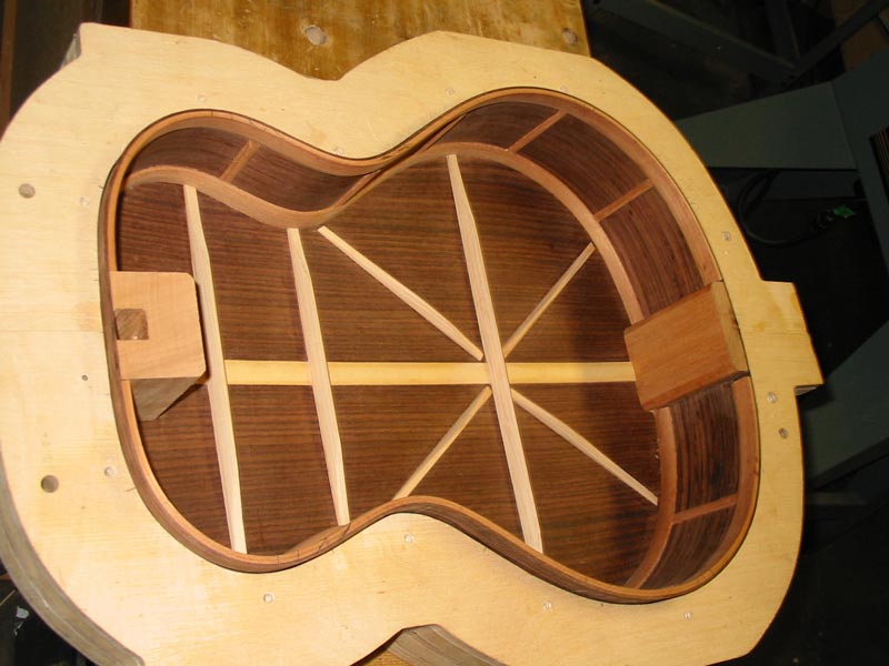

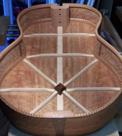

This is sort of a new design for me. I used something similar a couple
years ago on an ABG and really liked how it worked. This is for an SJ, I'm
not done with this one yet, so the jury is still out. The madallion is where
the lable will go.
long
