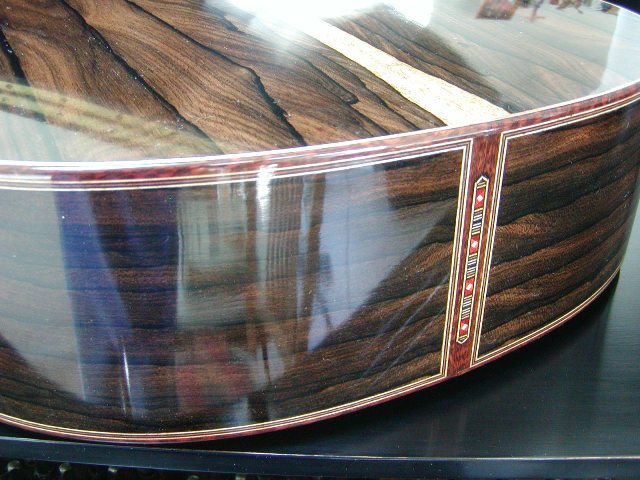

I'll admit I'm a purfling fanatic. This classical I have in progress is a bit over the top with five-line purfling between snakewood bindings and ziricote sides. At least this picture will help you decide if the extreme case is too much for your taste.

Dang, Gary. You have to warn us befor posting such a thing. I had to shut my eyes hard and grope blindly for my sunglass. Too much purfling? I'll let you know when my retinas return to normal.
PostPosted: Mon Oct 23, 2006 3:58 pm
Posts: 204
First name: Gary
Last Name: Lee
Actually I used a welder's mask when installing these purfs .

Gary, where did you get 5 line purfling? Did you make it?

Yes, I made them by gluing standard wood veneers with Titebond II to the plank of snakewood I got at Hibdon Hardwoods. Then I ripped the binding/purfling strips off the assembly. The veneers are natural maple, black-dyed maple, and mahogany.
