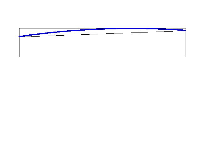

PostPosted: Thu Oct 26, 2006 2:10 am
Posts: 1106
Location: Amherst, NH USA
Making an arch that starts high at the tail of the guitar and goes low at the heal is visually almost identical to the flat/slope method. Look at the drawing. From the back to about the widest part of the lower bout there is very little change in height. Most of the apparent difference comes after that.
Fans of baseball will note that this is the same reason that curve balls appear to head straight at the batter and then suddenly break as they get near the plate.
Mike Mahar39016.4680324074

Thanks Mike. Thats what I was kind of thinking and your diagram makes it very clear. Wasn't sure if thats what you're all doing or if I was missing something.
I apologise for hijacking your thread like this Hesh !Cachalote39016.6806481481
