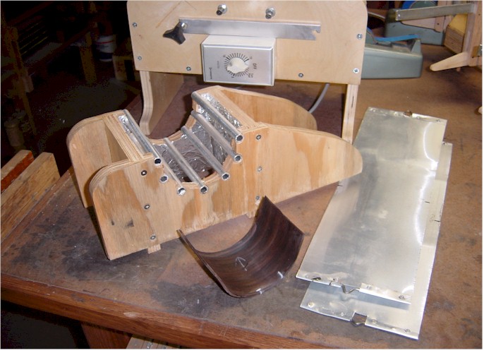

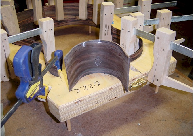

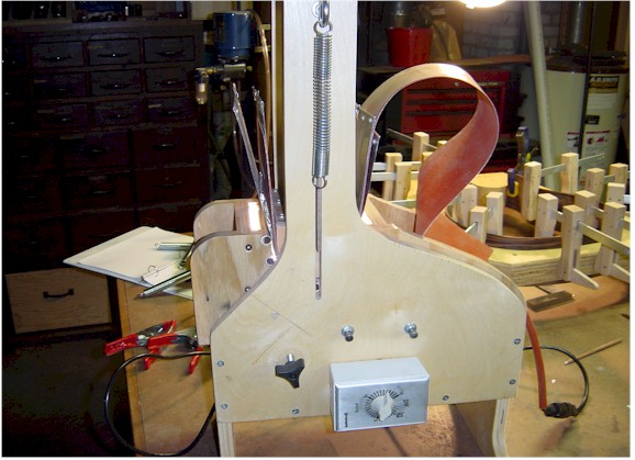

I don't know if anyone else has made this jig, but it works great! It's a mold that goes into the fox bender. I remove the 2 outer bulbs leaving just the middle one, and also use a blanket. I turn the blanket off after the press is completely down. Makes a perfect cutaway bend every time!
