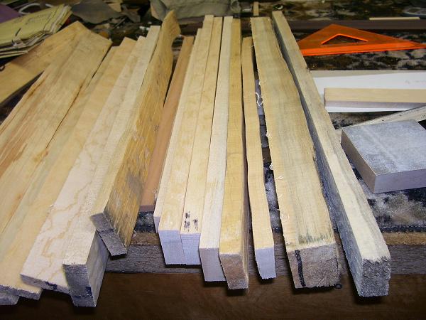

I got this brace stock in a while back, Lutz spruce. I bought 12 orders of the stuff so I could stock up for future builds.

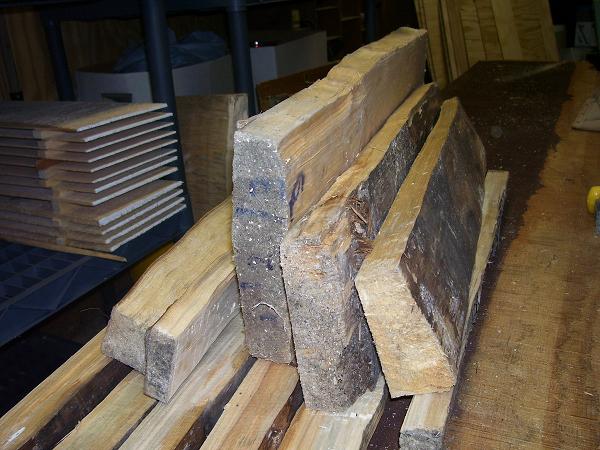

I was surprised when I opened the box and found big chunks of sapwood. They were split from logs that look like they had been sitting out in the weather for years.
I managed to get enough good clean bracing for 2 guitars out of it. Here's some of what's left.
Some of the outer wood is starting to rot and I have alot of blue staining on the rest. I just don't feel comfortable using much of this for bracing.
Questions:
Is it common to use sapwood for brace stock? Most of these pieces do have 30 to 40 grain lines to the inch.
Is there a way to get rid of the blue stains? Much of the wood is sound but has the stains.
Did I get Hosed?
Thanks in advance,
Horton, MI

Kirt,
The stuff you used will be fine. What would be interesting to do, and I will do that, is to determine the difference in density between Lutz sap wood and Lutz Heart wood once they are both dry. I will try and do that later today. If there is no difference then the only real issue would be the colour difference which would be an important issue for the top but you could keep a homogenous colour for your narrow brace stock so wouldn't be an issue there. In the photos you posted I would be just mostly concerned with the 'wave' I see in some of those pieces. On thin braces you loose some of the strength as those 'waves' run off and back on to your brace. If you got some nice pieces out of the stock you had then you will be fine. You care enough to ask, that already says something about the intregity you are putting into your build. I just believe that braces are almost more important than the top wood and therefore will continue to turn sap wood from sitka species into heat. In my opinion there is not a lot you can do about the blue stain, just too much water locked into that wood, unless you processed it into smaller cross sections before you dried it.

Thanks Mario,
The wood wasn't green it's been laying around for a while. It just need to dry out some. The blue stain goes all through the pieces that have it. In the first photo that wide piece is how it all came. You can still barely see the markings on the end that shows that chunk to be 3 bracewood "orders". Probably bigger than the pieces that Shane sells but by the time you split off the waste... not much left. The second photo is what I ended up with after I split and sawed the other "billets".
