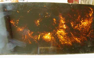

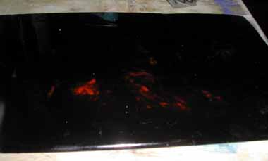

Well I've been looking around for some pickgurad material for an old
Gibson A-Jr. mandolin and I could not find anything I liked.
So I made a little mold and mixed up some West Systems epoxy in
dark red brown and amber to make my own blank.
The finished blank is about .1 thick and has the color and look I was
wanting.

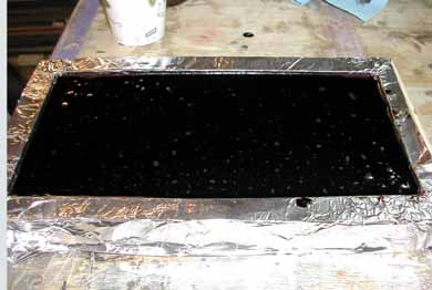

The first shot is the epoxy in the aluminum foil covered mold. The
next day I ran the blank through my thickness sander to true up the
surfaces, then much wet sanding and buffing.
Enjoy!
- Louis Freilicher

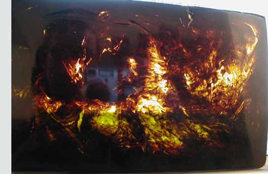

Interesting! Can we get a better picture, it is a little hard to tell exactly how it looks.
Have you started shaping the pickguard yet? Is so, was it easy to cut, shape and polish and so on? How stable does it seem?
This is how "Tot-Tis" is made too, no?Arnt39009.745625

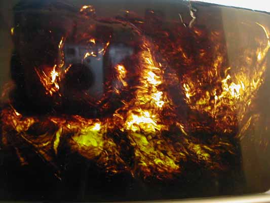

This thing is pretty hard to photograph but here's a few more.
So far the material seems to work and polish well. I cut the shape on
the band saw (with a zero clearance insert) with no chipping or
cracking. I sanded and polished it the same way I would a lacquer
finish.
The material (after 72 hours) is firm but a bit flexible, defiantly not
brittle
Louis

The color is trans tint from stew mac. For this guard I mixed two
batched of epoxy. For the dark color I used four pumps of epoxy,
four drops of dark walnut, two drops cherry red and two drops of
vintage amber. The light color is 2 pumps of epoxy with four drops
of vintage amber.
I heated up the mold and the epoxy with my grizzly heat gun and
poured the dark color first. Then drizzled and swirled in the amber.
I tried to keep it heated to the point where I could see air bubbles
popping on the surface. Too much heat and the stuff will set up
faster and you will wind up with more air bubbles.
I'm just about done polishing up the finished guard, so I will post
more pics soon.
On a side note I'm doing the restoration on this mando in trade for a
pearl engraving workshop next Tuesday, so I’ll post something on
that when I get back home.
Louis

Thanks for the input Kim, very good info. The aluminum foil was
used on my second pour attempt. The wax paper from #1 is still
firmly attached to that blank. Most of the foil pealed off the blank
with almost no effort.

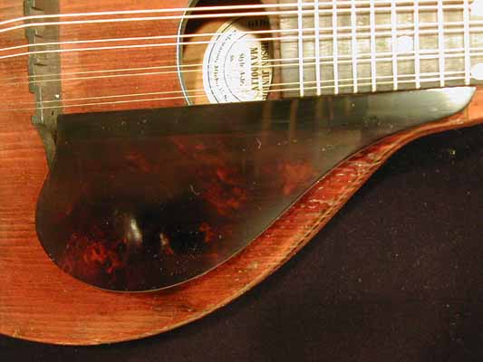

As for the air bubbles, I did end up with some on this pour. I used
the down side of the mold as my show side and sanded most of the
air bubbles out. Some I filled with thin CA as I sanded down the
backside of the guard. The small fills on this dark guard are
invisible from the front, but with lighter colors they many be more
apparent.
Since this blank was for an archtop instrument I wanted a thicker
blank than one would need for a flat top guitar. I think the thinner
pour would be easer to remove all the air bubbles from. Some of the
bigger ones I popped with an old high e string and they settled in
just fine.
The trick is to find a setting on your heat gun that gets the epoxy
thin enough to breath but not so hot that it sets up too fast. On my
first attempt I set the mold under a light bulb and wound up with an
island of very hard epoxy surrounded by a lake of thin epoxy. That
guard basically has a sun spot now.   In terms of the heat affecting
the cured strenth of the epoxy it may be a good thing for this use as
it may help keep the finished guard from becoming too brittle. This
stuff has about the flex you would expect from a .090” thick piece of
celluloid.
Well, here is a shot of the finished product. My only concerns at this
point are how this thing is going to hold up. I am hoping that it
doesn’t become brittle over time and crack. While I had this sucker
on the buffer for a final polish I did catch an edge and the guard hit
the concrete floor and survived, so I hope that's good news.
Louis

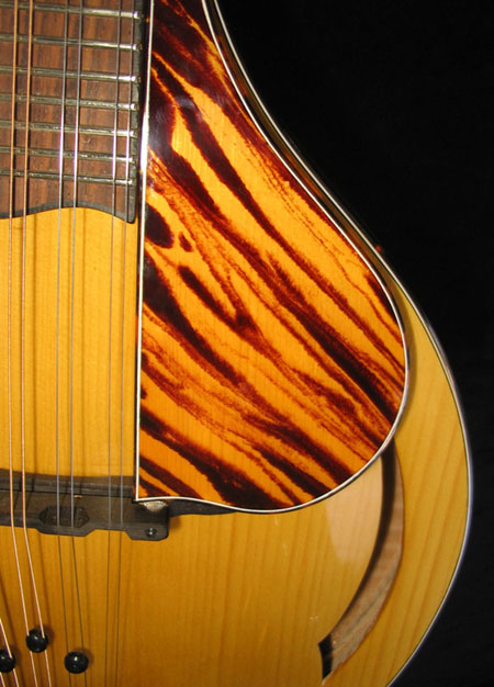

You have me thinking... I use Greven's Tortis material for my mandolin pickguards, sticking it onto a piece of scrap guitar top spruce, then binding it with binding I cut from the same sheet of tortis material. It makes a stable, and very lightweigth pickguard, and the light colored spruce adds to the 'guards color and texture. I have also used flamed maple as the backer, giving yet more options for different 'looks'.
What I'm thinking you could try with what you've come up with, is to mix the epoxies directly on the spruce or maple backer. Perhaps this would allow a thin layer of epoxy that wouldn't need thickness sanding and wouldn't have a chance of becoming brittle with age. Also eliminates the foil step... All that would be needed would be a level sanding and buffing. Worth a shot if you want to keep messing with this sytem(and I think you should, as this looks really neat).
Here's an example of one of my guards. The shot was taken with flash to show the spruce underlay better, though it exaggerates the color a bit. as an added 'bonus', the spruce underlay will darken att eh same rate as the mandolin's top, so the 'guard should retain its color match as everything ages.
