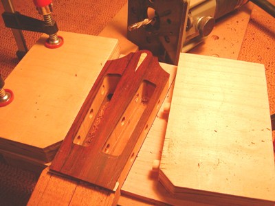

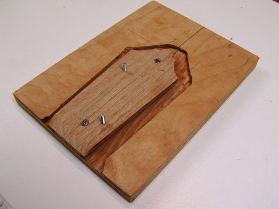

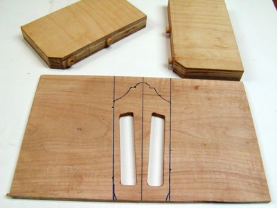

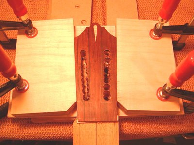

Here are my solutions for shaping classical heads using a laminate trimmer and flush trim bit.
First I cut the head profile by screwing the headstock to the jig through two holes drilled in the slot region. The machine screws come up from the underside of the jig. Note that the head template can be unscrewed from the base so that I can position the template to the headstock and mark the placement of the holes for drilling. The bolts go into the headstock but don't protrude above surface of the headplate.
Next, I drill the roller holes using the Gilbert jig from LMI. Sorry, I don't have a better or cheaper way than this.
Then I rout the slots with a jig that secures the head with dowels that fit snugly into the roller holes. Like others, I drill the bulk of material out of the slot region prior to routing. Because the system is acually three pieces simply clamped together, it is very flexible and can accomodate different size/shaped heads and slots.
