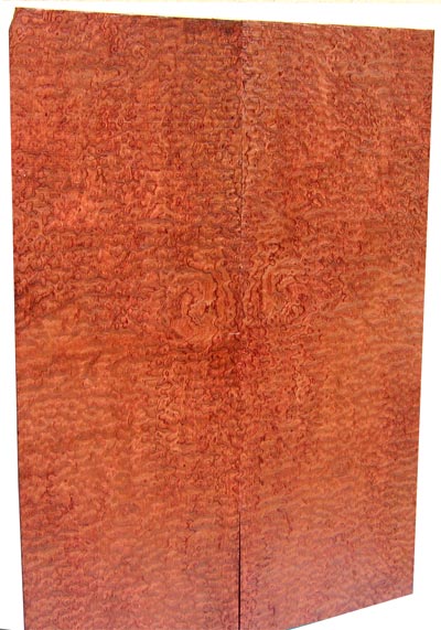

PostPosted: Mon Oct 09, 2006 10:11 am
This picture from LMI is probably more like what Todd is refering to...:
The waterfall stuff is reasonably stable. Several people have built with it with fine results.

PostPosted: Mon Oct 09, 2006 10:44 pm
Posts: 2687
The stuff that Andrew shows in his post looks almost exactly like what I got.
Chris, thanks for your input. I'll take your word for it. Maybe if the guys I got this from don't want me to return the broken sides, I'll try bending them and see what happens. It hardly seems possible that this stuff could be bent without breaking, but if others have done it, than it can be done.

Larry, gotcha. And you're right, I think packaging was an issue in this case.
I'm fully cognizant of what you're saying about figured wood. I've just never seen a guitar set where the runout due to the figure is as extreme as on this stuff. "Runout" is an understatement. The undulation is so extreme that in many places, the grain runs directly across the board from one surface to the other. I don't see that on any of the other highly figured woods I have in my stock.

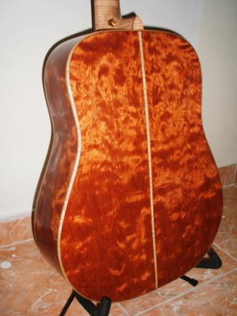

PostPosted: Tue Oct 10, 2006 2:16 am
Joined: Mon Sep 18, 2006 12:31 am
Posts: 49
Location: Vietnam
This is a 12-string built with bubinga from LMI, bearclaw sitka top, and maple neck. It is difficult to compare because I don't have my Gibson 12 around. It sounds a little "tight" right now but I expect it will "open up" with more play. I have only had it a month. 12 strings are always difficult for me to compare with 6 strings because they have so many high note strings.
My friend said bending the sides was difficult and comared it to some quilted maple he did for me.
