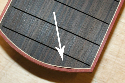

I need to fill this gap in this fingerboard. Using dust and CA leaves a much darker area than the natural bloodwood....
Any sugestions?
PostPosted: Mon Oct 09, 2006 4:46 am
I'm thinking mabe loosen the binding to the right of the gap, shorten it slightly then reglue. Just a thought.
PostPosted: Mon Oct 09, 2006 6:32 am
If you don't want to reglue the joint, then take planed off curls of bloodwood to fill it. pretty simple and will be near invisible
PostPosted: Mon Oct 09, 2006 9:18 am
Thanks Michael.. thats what I had in mind and I guess that may be the best solution.
