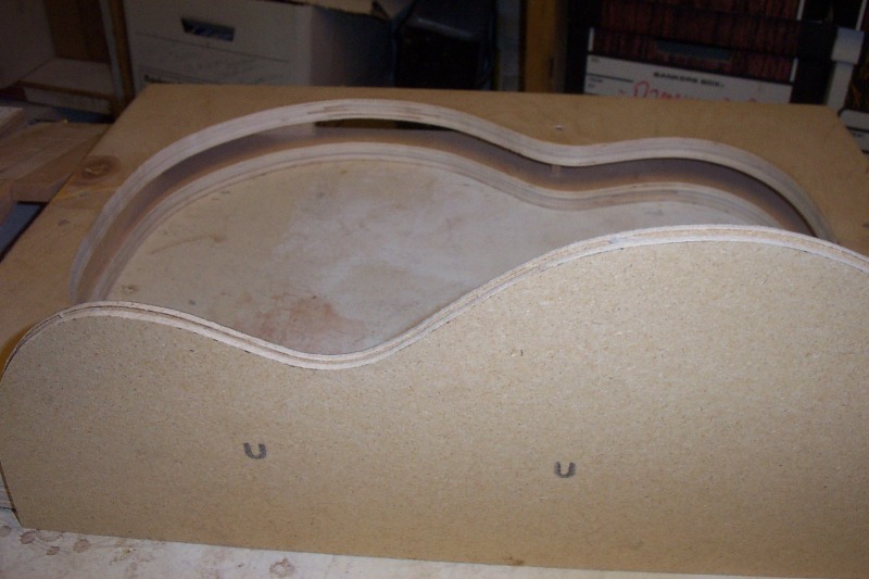

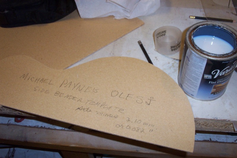

Here, while waiting for my SJ plans, i decided to make the templates since i have Michael's body mold given by Andy Zimmer. Thanks again to both of you!

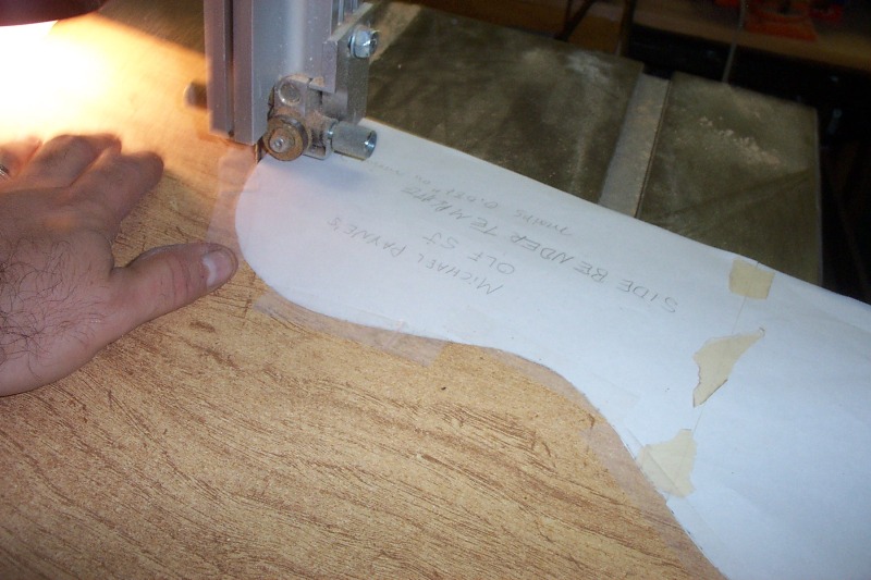

cutting the templates on the bandsaw

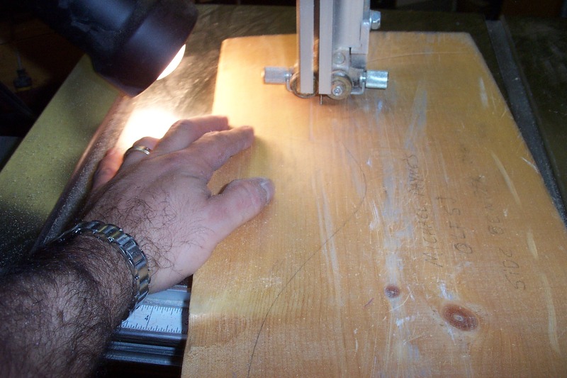

I applied a water base finish to the templates just as a protection since it's very thin
2 templates done, one for the body and one for the side bending machine that is reduced to 0.082" for the thickness of the sides

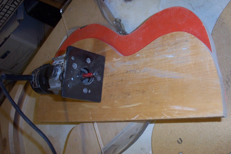

trimmed the excess with my trusty PC 7310
That's where i stopped building and started a huge clean up of the shop or let's say the beginning of another shop makeover, i'll post pics when i'm done with that also

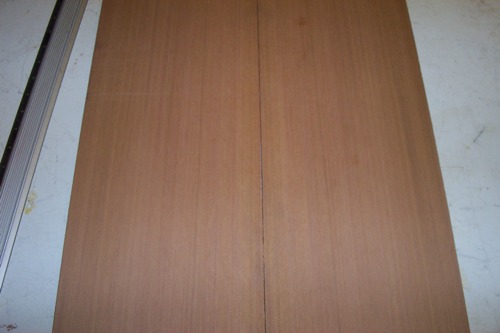

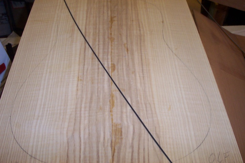

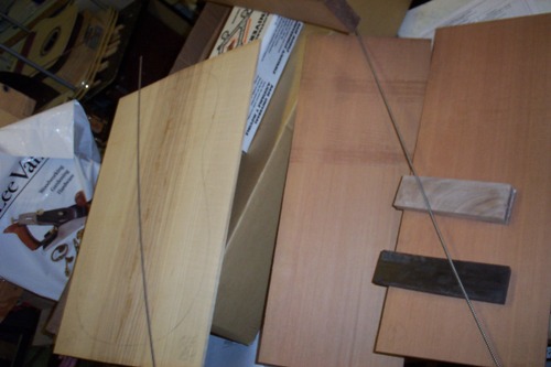

Thanks Hesh and Anthony, no 3 will be made with a red cedar top from Shane and a white ash back and sides from BobC, the bindings will be ebony and the purfs will be rope, both from my pal Russell Rose, for the neck, i plan on using Jatoba, a nice plank that my great bud Alain gave me recently, it should make an awesome lookin' one and it will be made for my Godfather Norman.
Here are a couple of pics of the combo:

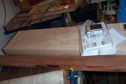

Here is the jatoba plank, near the drum of my drum sander

Hey Serge, if I may make a suggestion about the Jatoba.
before you get it to close to the final width (headstock max width I'd say) rip it down the middle, clean up those two inside edges and glue them back together but flip one piece end for end. This will help counter if the neck wants to warp in the future. One side will twist one way and the other side will tend to twist another, this way they theoretically counter twist eachother and don't twist at all, theoretically
