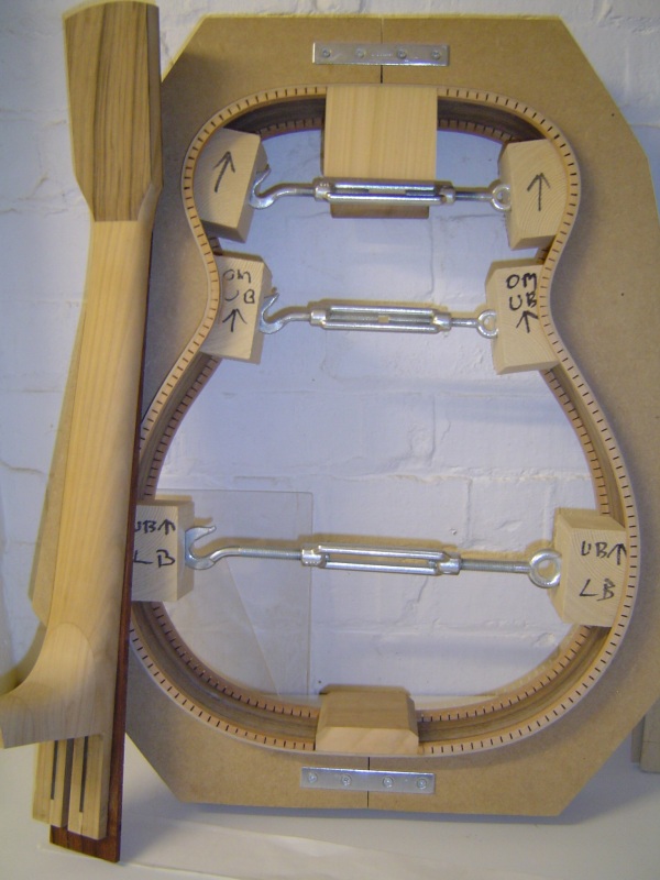

I tend to use a fairly massive head block with neck extension and a Spanish heel. The headblock is the heart of the guitar, it's the bit you hang in the air and everthing else is connected to it, so to me it's the first thing I make and the first thing I design. Also, my fingerboard is attached to the neck extension and is not glued to the top plate.   That said I still use a 12.5mm upper face brace, but no upper transverse brace, as the strings are still attached at either end and are trying to pull the whole guitar into a boomerang.
This is a pic of my latest Walnut OM, the head block is cherry as is the neck shown with it, don't worry the FB is not glued on crooked, its just propped up with it!
This is the headblock and neck extension.
