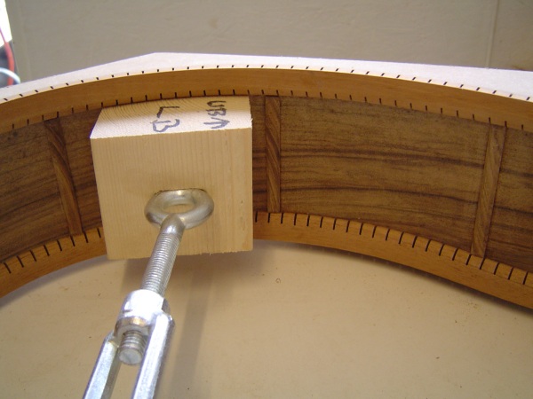

Michael, thanks, I've already done just as you suggest and used some of the side wood turned 90deg as I said in my original post that I might do. I really like the look. As I said I've built more than 20 guitars now more than half without side reinforcment at all and they have all survived fine. But, I do use side braces on my guitars that I take to clubs and festivals as insurance for just the odd accident.
They are not tucked as they were a bit of an afterthought This is how they turned out.
