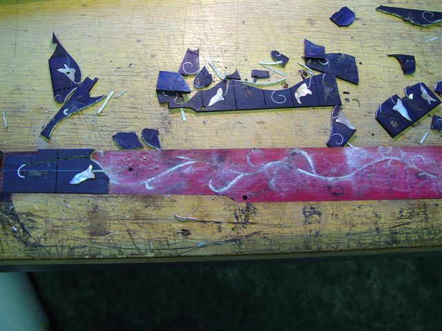

Here's the fretboard removal!
They had cut every inlay slot completely through the board. (Where was dremel company )

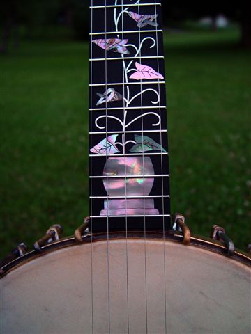

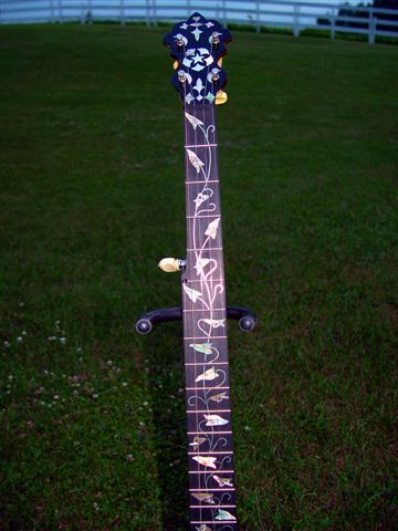

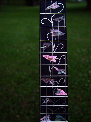

The completed restoration.
Pale red ab and pewter for the vine.
this last image includes the only inlays salvageable- The "flower pot" at the bottom. most of the inlays were only about .008, probably due to the fretboard being sanded down during it's lifetime.
I took plenty of photos and measurements prior to beginning the job to keep everything as close as possible to the original,(including the flower pot slightly off center!)

Ron, I never had a fretboard come off in pieces before;
Now that I think about it, it was enjoyable!!!!

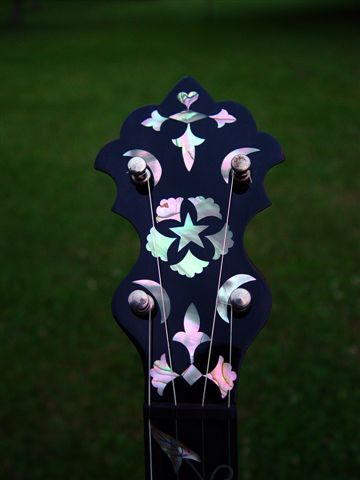

The headplate inlays were actually cut to fit the existing recesses, which had lost most of the shell.
I was even able to save the old skin by resoaking it.
Overall a great learning experience!
