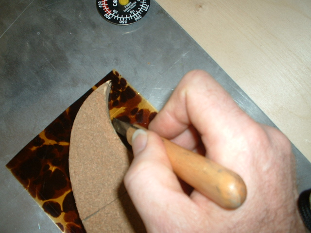

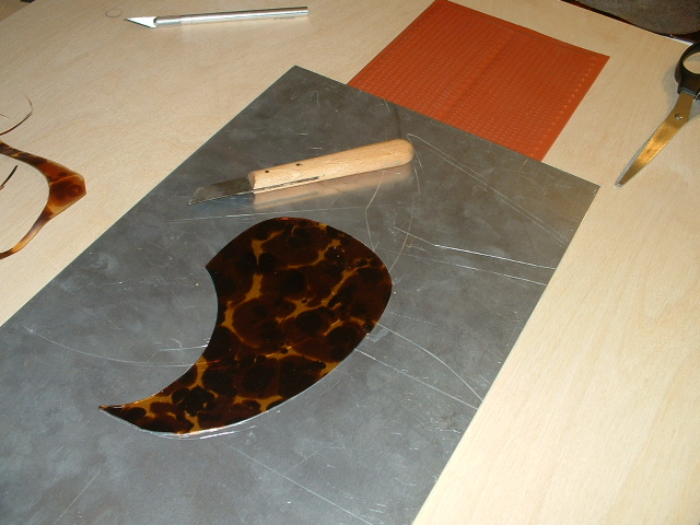

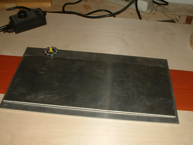

Regarding a recent discussion regarding Tor-Tis, I thought I'd offer a simple way I've found of working with it. It does involve some heat, but no water (messy). A few pictures will convey the idea best, I think:
Heated up to ~ 135 degrees F, it cuts like butter; much hotter and it wants to stretch. Use a sharp knife and one pass is all that's needed. Take the aluminum plate off the heat blanket and in a minute or so it's hard and ready to bevel and polish. Works like a charm for me.

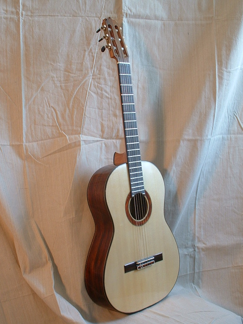

Here's a pics of one of two models of classical I build:
My classicals and flamencos are French polished; I use Target USL on most of my steel-strings.

James...welcome to the OLF. On your heating plate is that some sort of surface thermometer?

This is a great idea! Looks like that's a metal plate on top of a side bending blanket.
I was thinking about trying some plate glass on a food warming tray.

Hi Brad. Yes, it's a simple bi-metal surface thermometer. I keep several of these around. Very handy for checking temp of bending forms, heat blankets, etc. I calibrate them using my DMM and a thermocouple. They are reasonably accurate and are cheap ... $7.95 at my local hobby shop. I think Stew-Mac sells them too -- different brand, cost a bit more.

Some follow up info regarding surface thermometers.
Available as "Grill Surface Thermometer", designed to monitor surface temp of BBQ grills and fry pans. Can commonly be found as cooking supplies for about $10.
