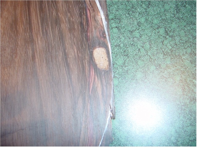

I'm new to epoxy. I plan on cutting the knot out of this backplate, and joining a piece of the waist scrap to replace it. I was planning on using epoxy as you guys had recommended. What brand or type would you use,(5 min. epoxy?), and do you just clamp it using tape till it sets?

Don't use 5 min. epoxy. Use somehting like Smith, System 3 T-88,or West System. Any of of these would work fine.
PostPosted: Wed Sep 20, 2006 11:07 am
West System Epoxy IIRC the numbers are 105 for the resin and 205 or 206 (fast slow) for the hardeners. You can probably buy it locally. Check their site. They sell to the boating world.
It is great stuff.
