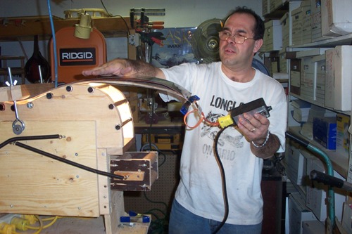

What Martin said, i built one with 3-200 watts bulbs and added the heat blanket after, the combination of both helps to keep the temperature steady on both sides of the wood, here's ma bender in operation, i have the thermometer that was supplied with the blanket by John Hall:
With the bulbs and the blanket it does get really hot!

Serge that bender must put out some heat....are you building asbestos guitars???
PostPosted: Fri Sep 22, 2006 4:48 pm
[QUOTE=kiwigeo] Serge that bender must put out some heat....are you building asbestos guitars??? [/QUOTE]
no no, just cast iron!
