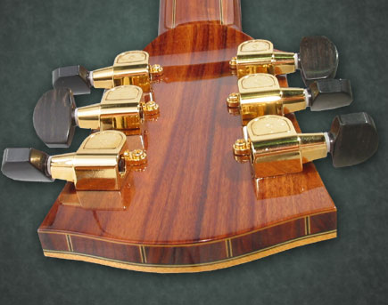

Paul/John, I didn't know vulcanized fiber/fish paper existed (duh me).
I have been using veneer. For a brown line - walnut veneer for black lines - black dyed pear. Seems to work well for me.
BTW: John - sharp looking neck!Anthony Z38982.9220138889
