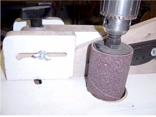

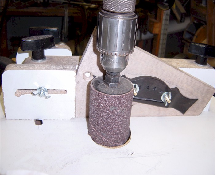

PostPosted: Tue Sep 19, 2006 12:42 pm
Posts: 147

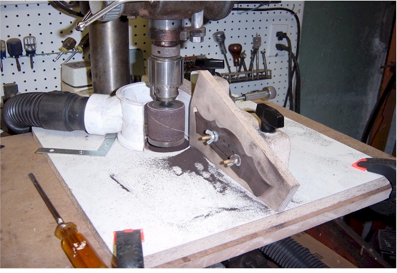

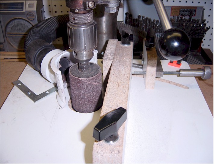

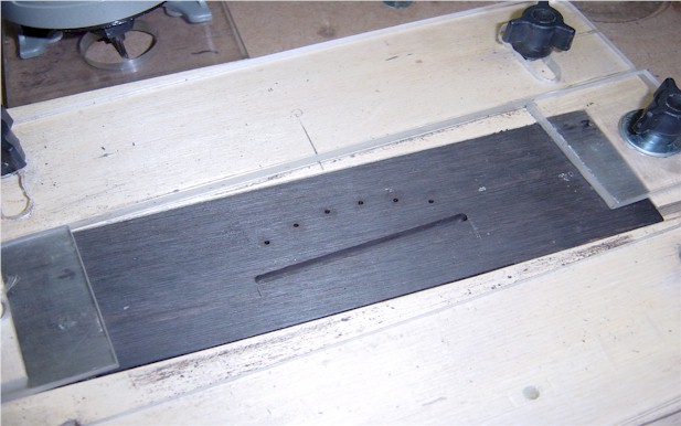

Terry, I agree with john, my drill press table edge is not quite 90 deg. with the chuck. I do my wings with this jig. You make the plywood sled, screws with wingnuts holds the bridge to the sled. by setting the angle of the sled to what angle you want on the bridge, you just flip the sled over to give a mirror cut to the other side. there is an adjustable stope behind the drum that stops the sled exactly where you want giving a nice clean line. The fence on the jig has an adjustment for thickness sanding. I use this for thickness sanding all my small woods. I know it's a sort of "luthiers friend", but I have modified it for mainly doing my bridges. Let me know if you want more pics, I'll post them.

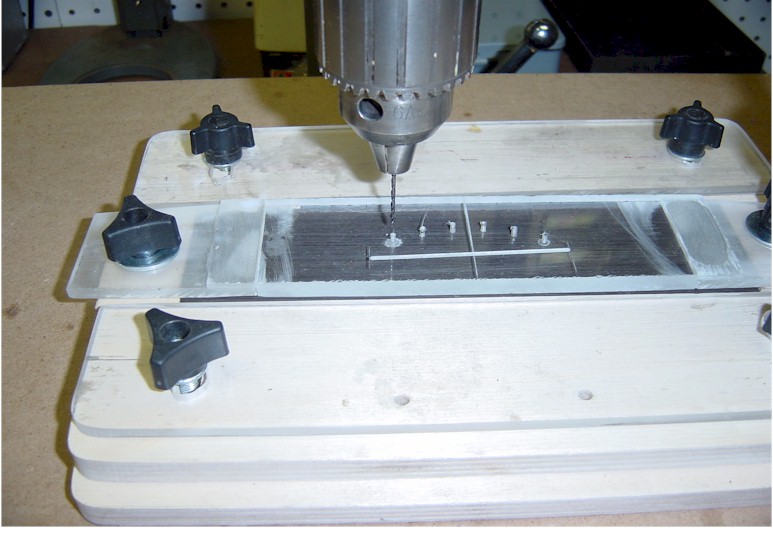

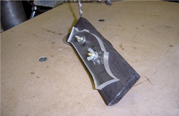

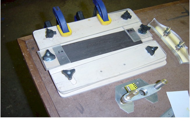

PostPosted: Tue Sep 19, 2006 1:58 pm
Posts: 147
Terry here's a few pics of my bridge jigs
