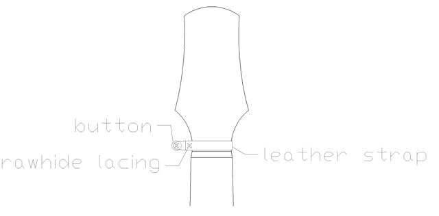

You need to pay attention to things like heel joint, if a built up heel was used ,grain orientation, and be sure the area you put the strap pin on the heel will be able to support the load with out splitting a seam or the grain. (yes on the trebel side) I had a client that specified that he wanted a strap pin in the back so that it was penetrating the neck block instead of in the heel of the neck. This actuall is a better location but may cause case firt issues. If you can, I would avoid strap pins all togather. The best thing for the guitar is to use a leather strap attachment that goes under the strings and arond the neck just behind the nut. This is the tried and true strap attchment that in no way damages the guitar and it does not put any hole in the guitar. Just my personal opinion.

PostPosted: Fri Sep 08, 2006 7:18 am
I have the part that goes around the neck made for me at a local boot shop. they cost me $6.00 each with custom tooling. All it is is a 3/8 wide pice of leather with rawhide lacing to hold the portion that goes around the neck togather and a button on the end that attaches to any comercial strap.
