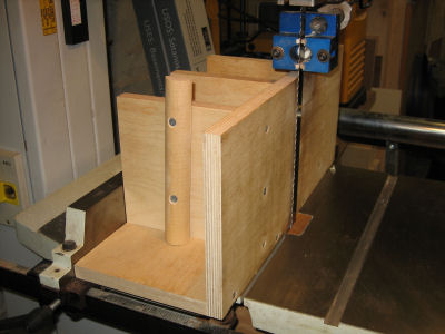

Brad, I use a fence setup like Steve does but my fence ends just past the cutting edge of the saw. The reason is that if the wood has internal tensions it will bow or cup as it comes through the saw pushing the board away from the fence. I find this helps my thickness consistancy

I have resawn lumber for years on my 14" delta with
a riser block. I use a fence like SteveS shows.
I find i get the best cuts by making sure my fence
lines up with tracking of the blade cut. My fence has to be set at a angle to the miter slot.
The angle changes slightly from blade to blade for me.
Now maybe it is not a issue with your saw or others.
But for me it is a must. Hope this helps.

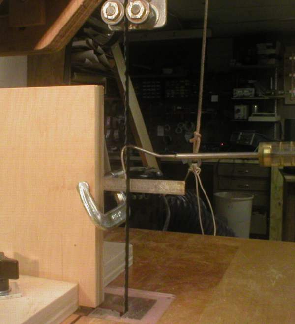

Here's an easy way to check your blade tension on the cheap:
First, set up the guides pretty far apart (for example, 10 inches; the further, the better).
Then, set up a ruler to measure the sideways deflection of the blade, and pull sideways on the blade with a spring scale with a few pounds.
By measuring the deflection (d), and knowing the spring scale force (F), and the height between guides ( h), you can calculate the tension (in pounds) :
T ( pounds) = ( F x h ) / ( d x 4)
Then, you can take the cross sectional area of the blade you are using A = ( thickness x width) and figure out the blade stress ( S) in psi :
S (blade stress in psi) = T / A
For the width of the blade, you should use the width to the bottom of the tooth gullet, which will be a little less than the total width.
You can tension your blades to 30,000 psi safely. I usually end up at about 20,000 psi, and that works fine for me.
If your saw can't tension the blade to at least 10,000 psi, you should probably switch to a narrower blade so that you tension it to a higher stress.
Also, if you ever want to measure guitar string tension, the same method works fine for that, also.

I forgot to mention in the last post (measuring bandsaw blade tension) that you should to set up the ruler (and pull with the spring scale) midway between the top and bottom guides. Otherwise you won't get the right answer.
