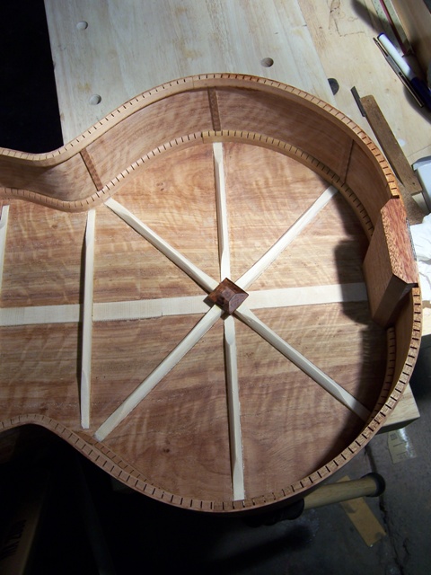

As Dave just stated, it makes the back more cntrolable in it respoce I use a star shape on SJs and Dreadnaughts(a 90 deg X with added laterial fingers) this also suports the dome shape better. It als allows me to use shallower and thinner braces there by reducing mass.

Any photos of yours you'd be able to share? Thanks.
-j.
-jack handy
PostPosted: Sun Sep 10, 2006 11:55 pm
Yep just a min and I will find one
PostPosted: Mon Sep 11, 2006 12:02 am
Here is your picture. This is an SJ
MichaelP38971.3781481481

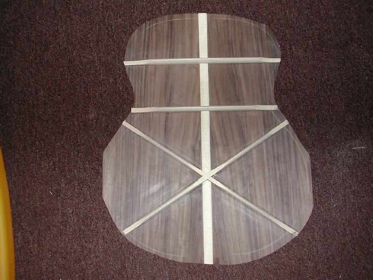

Here's a pic of mine(I know, the X is off). This was my 2nd guitar, and I really love the sound of it. I love X braced backs, I think they look cool and sound better. To my ear, at least.
PostPosted: Mon Sep 11, 2006 11:46 am
Posts: 3999
That's about the layout I use. I generally end up with the X tall in the middle and tapered off, and the waist bar quite small, but that's just what seems to work for me. The X angle is probably important, but I haven't figured out yet how to get it 'right' the first time.
