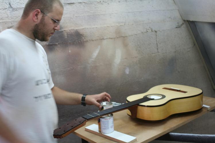

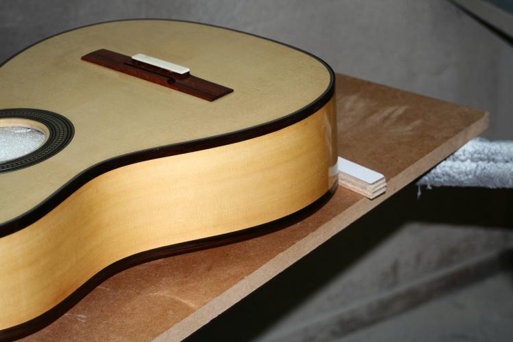

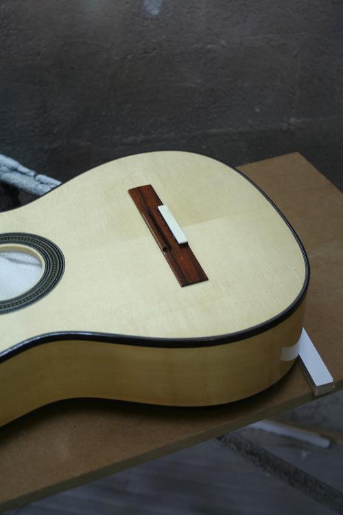

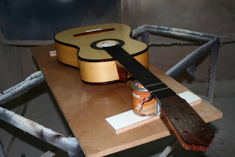

Hey,
just wanted to share some pics with you guys.
there has been some discussions here lately about flamenco action, alaskan yellow cedar and sorts, so i figured that now when it actually has a shape and can be recognized as a guitar i might as well post some pics.
this one is based on Bill Lewis' Barbero plan.
yellow cedar B&S are from Dan Mainard, who was kind enough to sand them down to thickness as well.
top is a maganificent piece of engelman i got from Steve @ colonialtonewoods, and same goes for the all the inside the box wood(carpathian sprcue) and the mad.rosewood appointments.
it is BEING fisnihed with a german made varnish that i picked up at the local ACE.
i m very happy with the varnish, its clear,beautiful and shiny without even being buffed - only problem i have is it dries slowly- 10 hours between coats.
luckily its all hard, shiny and pretty much done after two coats.
back to university soon.
really hope ill manage to squeeze some more work in the meantime.
take care,
Udi.

Udi, clean and classy!
Nice job man!
PostPosted: Fri Aug 11, 2006 11:09 pm
Wow, neat job, Udi!!
Very clean lines, lovely contrast between the rosewood bindings and the spruce/ yellow cedar!!!!Sam Price38941.3403472222
PostPosted: Fri Aug 11, 2006 11:27 pm
Well done Udi! Good luck in getting it finished before the school year starts.
PostPosted: Sat Aug 12, 2006 12:21 am
BEAUTIFUL!!!
PostPosted: Sat Aug 12, 2006 12:22 am
very nice, I love the wide bindings.
PostPosted: Sat Aug 12, 2006 1:04 am
Posts: 260
Beautiful work, I like the wide bindings too. What's the brand of varnish you used?
                   Paul Harrell
PostPosted: Sat Aug 12, 2006 1:11 am
Nice job, Udi. I really like the wide binding, too. Very bold looking. Beautiful work.

thanks guys!
the bindings are really dark mad.rosewood i got from Steve@colonial.
they are of average width(0.08" +/-), though a bit tall-around 1cm tall. i liked it like that coz i felt the bright colored top/back/sides just cried for something dark to border it and break the brightness.
the top is simply "double purfled"(b/w/b/b/w/b).
again, for the same asthetic reason.
the varnish is called "yacht varnish", you can see it in the pics also.
it comes ready to use and requires no thinning or mixing.
Udi.

For the varnish, how do you apply it? Foam brush, cloth?
I'm really interested in this, can i buy it a HD? There is no ACE store around here...
Thanks in advance
PostPosted: Sat Aug 12, 2006 3:47 am
Posts: 214
Location: Israel
Serge,
i applied the first coat with a brush, second(last) coat was sprayed on.
the varnish is very fluid and can easily be applied with a foam,cloth or brush.
it is also available at Home Depot over here so perhaps itll be worth looking into.
Udi.
