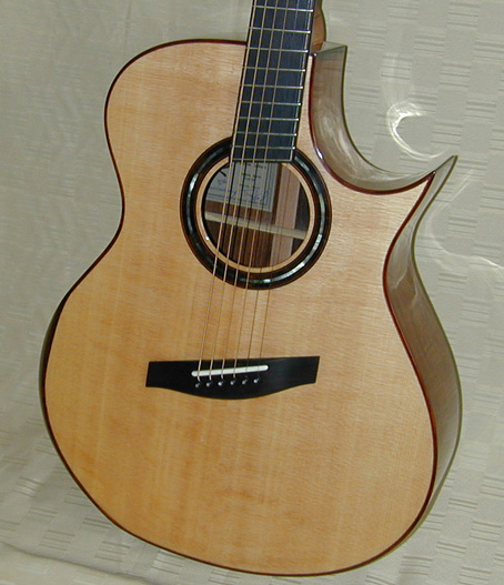

I like to leave a reveal of sorts at the cutaway on the top, ala Larrivee. I like to see the mitre joint in the purfling, and then for an edge treatment on the sode joint, I inlay a piece of contrasting wood, usually whatever the binding wood is. the look is like this ...
PostPosted: Fri Aug 11, 2006 2:28 am
That's a beautiful cutaway Tony! Heck, the whole guitar's beautiful! Nice work!
