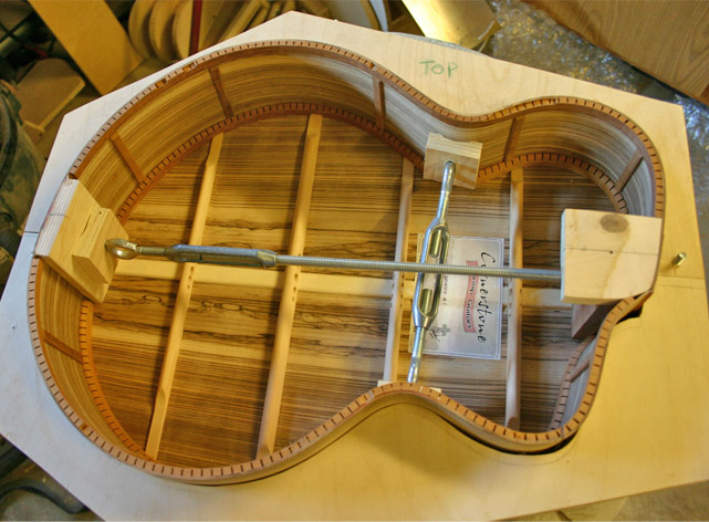

The Genesis is coming along...
Slowly but surely...
tonight I'll glue on the top and start working on the neck. If everything works out I'll have this one ready by the year 2010

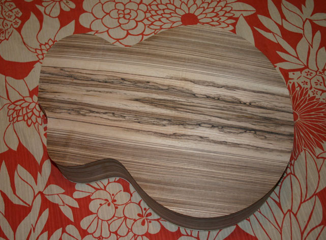

Zebrawood from the Zootman himself!

I guess Zebra. Hey,Peter stop right there. That's pretty enough to hang on any wall. Maybe print a pic for framing then build that baby. It's gorgeous. Are those port holes in the back braces? I think you can safely cut up to one third of a framing member.Dickey38928.9593634259

You're off to an exceptional start, Peter! The Zootman somehow came up with the best zebrawood I've ever seen, in pictures or in person. Everybody else's looks like a UPC sticker.

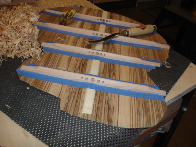

I drilled some holes on the back braces for decoration and to reduce weight a bit!

Nice work Peter! I like those back braces.It's fun to carve them with the little finger plane,isn't it? It's one of my favorite things WTG

Just be carefull when scraping the Zwood... The early wood tears easily. Keep them scrapers sharp.

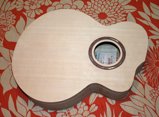

PostPosted: Mon Jul 31, 2006 3:06 am
Thanks guys, I'll be toping this one with a nice Lutz top.

Well, the box is closed! It may be sooner than 2010 after all!
