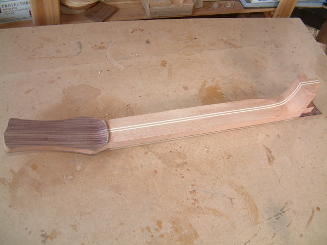

Hi guys, does any body have a good technique to glue a headstock back venner without a vacuum clamp? I just finished a neck and a nice zebrawood back venner will do the trick!

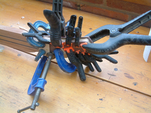

I bend the veneer on my hot pipe to match the volute, rough shape it except for the back volute curve which I get pretty exact, and then glue with titebond and a multitude of clamps. I find I need to have a lot of clamping pressure at the back of the volute but not so much as the front hence the clamp mixtures. When the glue is dry I shape the veneer to the headstock - I sometimes use the beltsander, and other tines a piloted router bit:

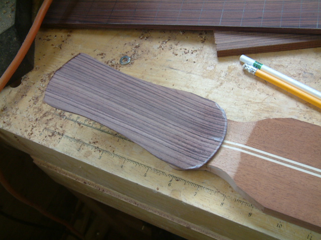

How thick is the veneer you want to use? I usually use a standard thickness veneer of about 1/32 or .7mm
Take a couple pieces of carpet pad and put that between the clamping caul and the volute. Don't forget a piece of wax paper or you will have fun picking the carpet foam off the volute if any glue gets on it. The foam pad when compressed takes up any gaps that there may be between the caul and the volute. This works really well if your veneer is thin.

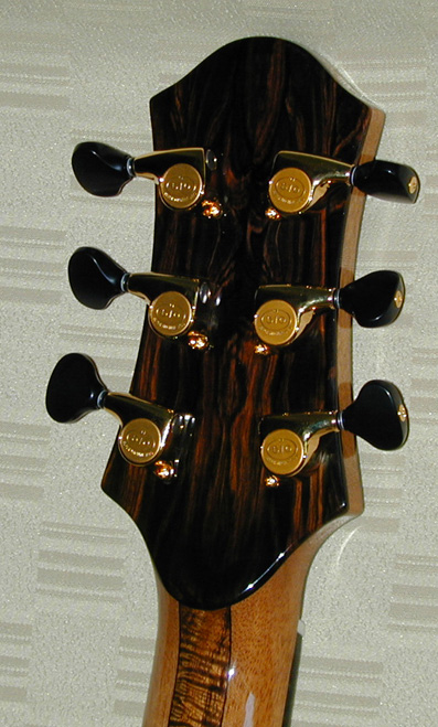

Hi Rod .. most of them never turn out well in photos, they all end up too dark to really show the grain and figure .. but here is a pretty good one. The photo again doesnt really do it justice.

Thanks guys, I kinda do it that way too, but this time I am going to use real veneers (the real thin stuff!) rather the a thicker veneer....
thats why I'mm worried

Mine are about 75-80 thou - you need to bend them first for the curved area.

Thanks Tony, I just got done gluing mine...some clamps and a felt pad did the trick..
I was worried because this one its only about 20-22 thousands thick (or should I say thin?)
