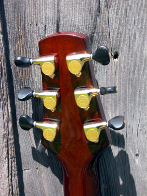

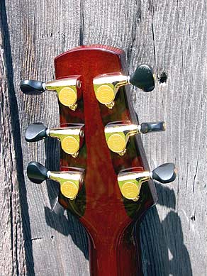

The file size should be as small as you can make it with the software you have before a detectable degredation occurs.
Here's a shot of one of Hesh's beautiful guitars from his web site. The shot on the left is 140k (I reduced it from 165k to get it past the forum software). The one on the right is actually more vivid and detailed than the original photograph, but is only 30k. All it takes is a copy of Photoshop and a little practice.
John Watkins38915.6825694444

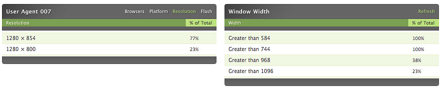

I've been using this $30 web stats program called [URL=http://
haveamint.com]Mint[/URL recently. It was released last year. For a while
I was thinking, "Why pay for sytled stats?" I've come to realize how nice it
can be for R&D though. The stats are really easy to follow, but more
importantly, it goes above and beyond to tell you the resolution of a
viewers computer, their browser's window width, the version of Flash
player they're using. And it breaks it all down into percentages for you
too. What percent of your viewers have 800x600? What percent have
1024x768?
It's really useful for me because my niche is really these dynamic sites
that do stretch and have massive background images...and are all flash
based. How many people are using Flash player 8? Well if it's the
majority, I can take advantage of the features. Here's a screen shot:
