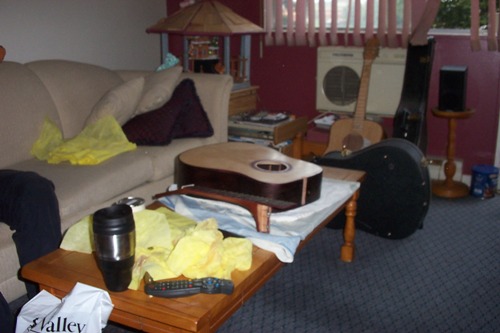

Hi guys, i have applied 3 coats of FP on my top and i have some spots that are not as shiny as others, it looks uneven or should i say blotchy in different spots?
What should i do with this please? Resand down to bare wood?

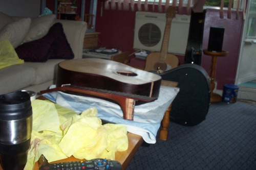

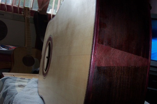

Hey guys, here are a couple of pics that show what the top looks like,
what are your thoughts?

Or is it just a build up thing and i'm just worrying for nuthin' as usual??

My best (inexperienced) guess would be that you are using too much oil.
What are you using as a guide for FP? Milburn? Robbie's video?
PostPosted: Wed Jul 12, 2006 8:44 am
Jon, no guide at all, just reading from the instructions from Lee Vally, small amounts and circular motion like explained, probably uneven motion or pressure on the cloth?

From what I can see, it's probably like Mark said. Maybe those spots are a little 'rougher' than the rest. What are you using for oil?
I guess you can always try a few more sessions and if it doesn't get better you can always sand it down and try again. That's the beauty of FP.

I'm still working on perfecting my fp technique, but I thought I'd pass along my experiences with this. I find that it is pretty common to have rough or uneven spots when I first begin fp'ing. I just continue to apply the shellac until I know I've built up a halfway decent amount of it. In this early stage of the process, I don't use any oil.
Then I sand back lightly to smooth the finish with 320 grit and a firm foam pad, cleaning the paper often as it gets loaded up. I don't sand back down to bare wood.
In my experience, the rough spots are caused by the grain being raised somewhat. Nice thing about the shellac is it fixes the grain in the raised position, so a light sanding gets rid of it. If you sand all the way back down to bare wood, you might end up raising the grain again with you next fp session.
I have also had situations where the color becomes sort of uneven on the top with the first applications, almost blotchy looking. The unevenness begins to disappear with further applications of shellac.

It appears to me from the little info you have given thus far and the picture that you need to build more. Three coats is not much build especially if you are using the method I show in my finishing DVD. Keep building and do not add oil and begin the polishing stage until you have enough build to do so.

Man, Serge, sorry I got here too late! That haze happened to me, too, and I also panicked. If it wasn't rough (like excess pumice), it was probably just oil. The test would have been easy. Make a new pad, put in a little bit of shellac and a lot of alcohol (though NOT dripping wet!), and then make quick, light-to-medium pressure strokes with the grain from one end of the guitar to the other. The haze would probably have disappeared.
Do this at the end of every session and the haze will minimize, and then disappear at your final spirit-off. You really shouldn't have to sand an FP finish at any point (no, I'm not there yet, either ), because it's all one coat, not several like lacquer.
