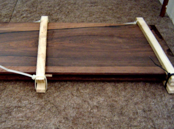

Two methods that have worked for me.
First, wet the cupped side and place it cup down on a concrete floor with a weight on top, it should flatten out over a day or two. When flat keep it under pressure on a flat surface until braced.
Second, use stickers and cable ties to gradually pull it back straight. Damp the cupped sides and stack them with stickers in between with the cupped sides out. Then use six cable ties to pull them together, over a period of a few days you should be able to gradually pull the ties tighter. leave them like this until you process them.
ColinColin S38908.4052083333

ColinS, that is a great idea on the 2nd method. Thanks for sharing I likey!
