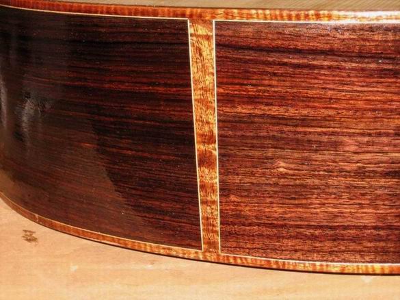

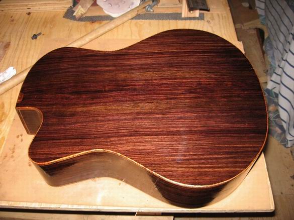

So now that I've managed to figure out how to downsize some pics, here's my second in progress.
Specs:
Adi top, Master Grade EIR back and sides, Flamed Koa trim and rosette, Mac Eb. FB and head plate.
That is a shape I drew myself. I call it a Modified D***d. I just took my old Takamines shape, tucked in the waist, flared the bouts and dropped the shoulders a bit.
What you see on there is a coat of System Three Epoxy on the back and sides and there's a wash coat of Super Blonde shellac on the top.
I got my binding and purfling from Shane at Highmountain. Awesome stuff and as always, top drawer service from one of our sponsors. Thanks Shane!
So from the inside it's koa/maple/koa/EIR/Koa
PostPosted: Sat Jul 08, 2006 12:38 pm
I really like your binding and rosette. Overall beautiful design and workmanship.
PostPosted: Sat Jul 08, 2006 1:11 pm
Very nice, Alain!
The more I see this combo (dark b/s, Koa binding), the more I like it. It is really handsome. One of those things to do for sure.
The single white purfling line on the sides was a gutsy move--but you pulled it off quite well.
SteveSteve Kinnaird38906.9253935185
PostPosted: Sat Jul 08, 2006 1:24 pm
Very nice shape Alain,and beautiful Rosewood.I also like the koa binding and rosewood combo. Very good work!
PostPosted: Sat Jul 08, 2006 1:29 pm
Wow Alain, that is looking wonderful! Will I get to strum it a bit in November?

PostPosted: Sat Jul 08, 2006 1:47 pm
Thanks a lot for your kind words guys!
Hesh, that EIR is from LMI. It's their highest grade. I don't think they call it 'Master' though. Yes, I've decided to bring it to Bob's.
Steve, the single white purfling was more stupidity than good sense Let's just say I'm not about to attempt than one any time soon...
Shane, unfortunately, this one is leaving home soon.    My very first personaly designed box won't even be mine. Me and my big mouth.
Pete,thanks man. The purfling I got from Shane was koa/maple/koa. Gorgeous looking stuff. I felt bad having to hide those flamy sides in a channel! I added a very thin 0.020 EIR lam to the Koa binding.. The EIR lam. had the same height as the binding. It was a bit of a pain in the derriere but worth it in the end.
PostPosted: Sat Jul 08, 2006 2:18 pm
Wow, just beautiful. Thanks for the additional photos. Man, there are some great guitars that come from this board.
PostPosted: Sat Jul 08, 2006 2:58 pm
Sweet work Alain! I love the shape and the binding, and the body shape...it may be leaving home, but someone's gonna be happy!
PostPosted: Sat Jul 08, 2006 3:05 pm
