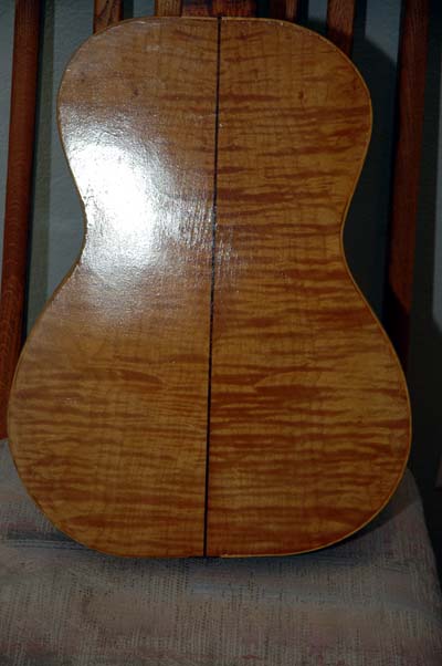

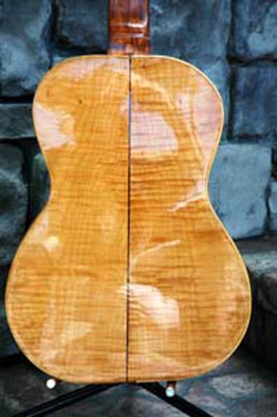

PostPosted: Wed Jul 05, 2006 2:46 pm
Posts: 113
Hi Greg,
I hope these pics assure you that a rough looking finish will rub out well with KTM
From that to:
While I am still needing to improve surface prep and leveling, I am having no trouble getting a good deep shine
Best Wishes,
Tomas
