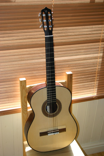

I Posted a few pics of this guitar in progress, On Sunday I had the honour presenting it to My Customer at his sons wedding, this had special meaning as my customer John is unfortunately terminally ill, and this was a project him and his son wanted to complete before his departure.
I must say a big thank you to my good friend ColinS who in very kindly made the beautiful brazilian rosewood bridge for me.

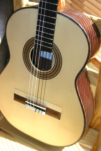

Great story and guitar. I'm sure it was a very rewarding experience for everyone involved. I do have a question though. What is the lite colored piece in front of the bridge and what is its purpose?

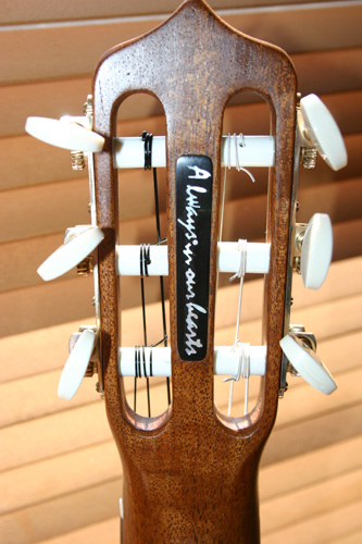

I like the "Always in our hearts".
Was that your own idea, or one of the family's?

Russell, I think the back of this guitar is one of the most beautiful ever. Congratulations on such a fine piece of workmanship. Okay, I'm saving these pics in case I ever do a classical. Great story to this one, thanks for sharing it with us.

The customer had the wood to make this guitar from for 30 year, and the top is a beautiful piece of German Spruce, but there was a small crack in the top which I closed with glue, but during final sanding it kept roughing up an I realised it went nearly all the way through, I discussed changing the top, but my customer wanted me to use the original, so I put the spruce patch along the front of the bridge to give it some reinforcement as I was worried it might open up in the future.

The always in our hearts was a request from the family, the reason it's on a little plaque is, John didn't know about it so I made it removable just in case, it also has his signature inlaid into the headstock.

Yes the bridge is the nicest bit

Russell, is that top purfling S175 and S6? If so, that is what I have just ordered, it seems that you are copying me, well OK you came up with it first, so it looks as if it's me copying you!
PostPosted: Thu Jul 06, 2006 5:28 am
Yes it is Colin.

Top purfling from where? Karin Rost, Touchstone?
That's a gorgeous guitar, Russel. What's the finish? The more I see satin instuments, the less I want to keep shooting gloss...
PostPosted: Thu Jul 06, 2006 6:46 am
HI Mattia
Its from Karin Rost
Its French Polish, but taken down with OOOO Wire Wool.
