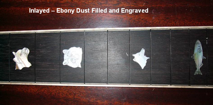

I inlaid the ebony headplate on a steel-string and used ebony dust mixed with CA as the filler. It blended in perfectly. A lot cheaper than the black CA, that's for sure.
