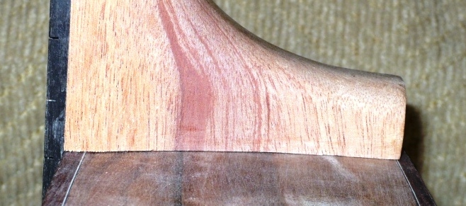

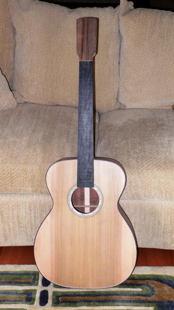

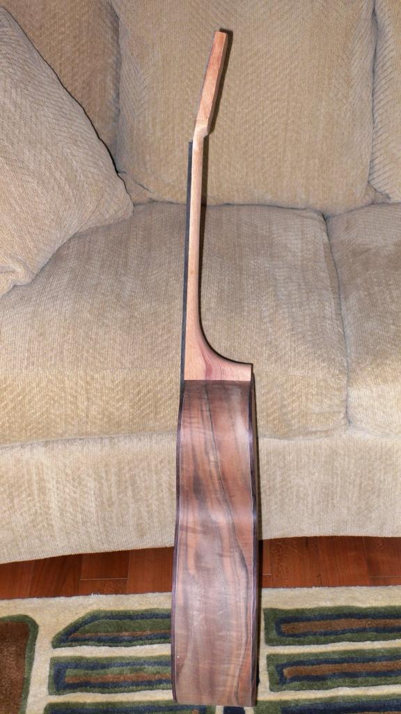

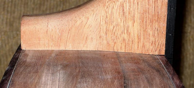

Hello,
Well, I've been trying to get a good fit between the neck and the body, and I am having a heck of a time. I've made sure the body is dead flat (top to back) where the neck sits, but as you can see below, I can't for the life of me get a good joint.
One side fits better than the other, and this may provide a clue as to what's happening.
Do you guys have any tips? Man, I'm taking a break for tonight.
Thanks in advance,
Pete

PostPosted: Sat May 27, 2006 12:38 pm
Posts: 552
Hey Pete;
It can be REALLY frustrating trying to get a good fit at this joint.
It's hard to tell from the pics, but the sides don't look quite flat to me. Use a good light source & a straight edge to check the body for flat.
It's way too easy to oversand the edges & end up with a big gap at the bindings. You have to glue sandpaper to a FLAT block to prevent sanding dips in the softer sections of the wood.
John Mayes makes fitting the neck look easy on his video using self adhesive sandpaper stuck to the body. The video is worth every penny!
Maybe he'll be nice & post a pic or two.
Good Luck, & don't lose hope!Daniel M38864.9025

PostPosted: Sat May 27, 2006 2:59 pm
Pete,
That's gonna be a nice guitar when you get it all together! Be patient.
It's clear from your photos that it's your heel that's not flat at this point. I can see undulations where it meets the body, on both sides. By all means, though, check that the body is flat and proceed from there. From what you wrote, it sounds like you had the joint right, using the Mayes method, before you tried adjusting the angle. Can you try that again? Just be sure you don't rock the neck while moving it against the sandpaper.
BTW, I don't think you can use the floss method here, because your fingerboard is already attached. You'd sand off much more on the bottom of the heel than at the top--great for a neck reset, but bad if you've got enough angle now.CarltonM38865.0018055556

Pete, It looks as if the body isn't flat start with that and fitting the neck becomes much easier.

PS I did check my sides again this morning and you guys were spot on - not flat but wavy, especially near the bindings. Sometimes we get lose sight of trees for the forest! Pete Harrington38865.5411574074
