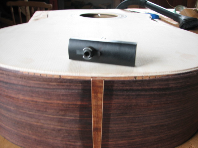

   My favorite tool as of late is my trusty Gramil. Man, I just love that thing. I free-hand my routing for binding and purfling. I use the Stew-Mac or LMI rabbeting set. Although my laminate router (grand-dady Rockwell 310M) has a small base I still can't get a perfect channel since I register from the top.

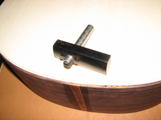

   With the Gramil I can get a very uniform channel. It's quick and easy to set up and very versatile.
   I guess the best would be to have a system where I register from the side... Another jig, another expense...

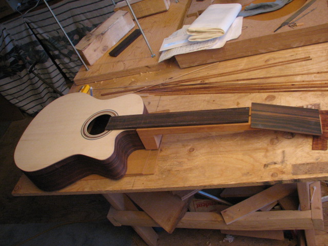

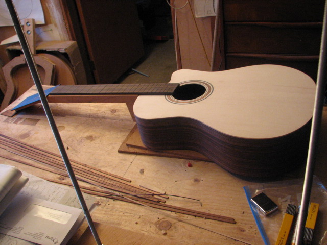

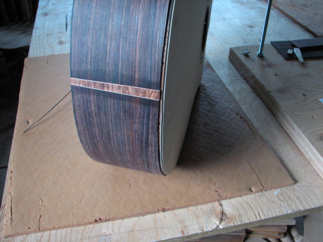

   So here are a few pics. The B&S are the best grade EIR LMI had, and the simple end-graft is flamed koa.

Yes, I'd love to see more of the guitar...but I'd really like an inservie on the gramil. Nice tool.

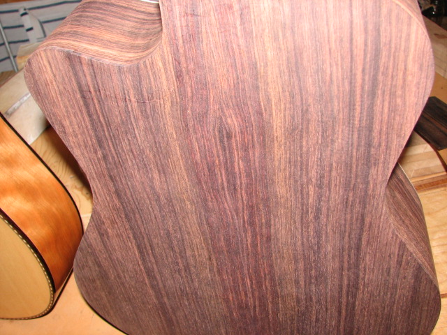

Oh is but that gonna be sweet! Alain the figure in that EIR back is to die for.

Yup, another sweet box that will come out of Alain's shop, that Andre guy will just love this guitar! WTG bud!

   Anthony, I too really like the figure. For EIR, it's pretty nice. Lot's of red. Should stand out under finish, I hope (fingers crossed... Murphy, stay out of my shop!)
   Bill, the Gramil I bought from LMI. In the forty-ish dollar range. Hock blade. Very solid and easily adjusted with an Allan key. Registers from the top or the side. Love it. I've heard of some people actually using just this kind of tool and a chisel to excavate binding channels...

I've done a couple of guitars' binding channels with just the gramil and a chisel, it is surprisingly quick and accurate too. I still always use the gramil to define all of my channels before routing them out, this helps enormously with avoiding tearout especially on WRC and is a kind of insurance.

Gramil users...that teeny-weeny blade is driving me crazy. How do you sharpen it?
BTW...the Sloane purfling cutter was designed for violins, and all its weight is above the channel, with a small brass guide registering against the side, making it difficult to control. The Schneider gramil puts its weight (a piece of aluminum) into the side register, with an adjustable arm holding the blade. Much more stable for guitarmaking.
