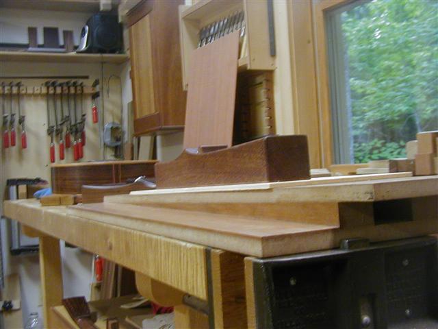

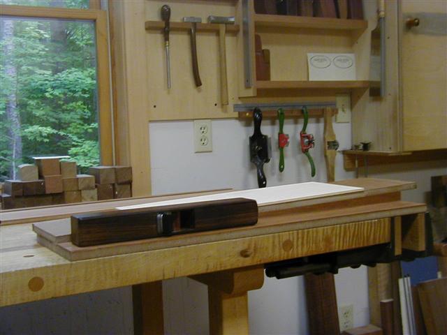

   It seems there have been a lot of posts recently about shooting boards and planes for edge jointing, so I thought I would share mine.
   My shooting board is ramped to that I use almost the whole width of the plane blade on every stroke, instead of just dulling an 1/8" wide part of the blade as happens with a flat shooting board. It may not be worth the trouble if you only join a few pieces a year, but if you do a lot of edge jointing it saves a lot of time on sharpening. I built mine originally to edge join sawn veneers that I use in my furniture work.

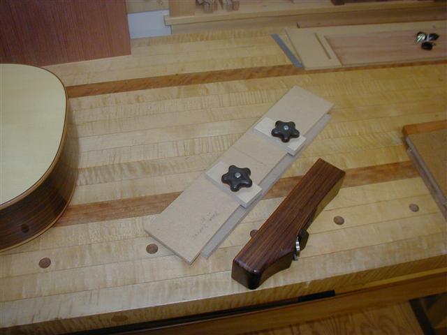

   My bracing jig, (got the idea here but I can't remember who gets the credit) is also a shooting board. I clamp the brace stock, run it through the table saw and then shoot the sawn edge with a plane to prepare the glue joint.

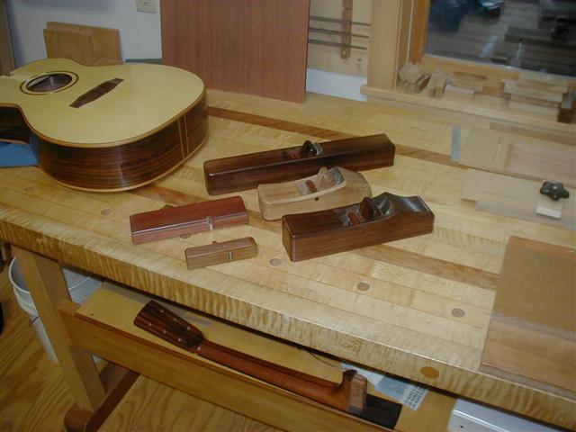

   Below are a few of the wooden planes I've made - from 18 to 21" jointers to the little 41/2" plane I use for brace shaping. The nice thing about wooden planes is whatever you need - any length, width or shape, you can make it in a couple of hours. I like the fact that they keep your hands closer the work than a metal plane, and I think give you a really good feel for how they're cutting.

How long is your shooting board. It looks just right for registering the plane along the whole cut. Also, I don't see any stops or clamps on the shooting board. Do you hold the wood by hand?

Thanks everyone; The man I learned woodworking from thought every glue joint should be planed so I got in the habit with furniture and it carried over to guitar building. I use my planes for everything from jointing tops and backs to preparing neck blanks to radiusing fingerboards. I usually thickness my tops with a plane too; not because it's efficient, but because I enjoy seeing big, thin curls of redwood, cedar or spruce comming out of the plane as I work.
   Carlton, I do have stops, I took them off to make the picture clearer. But it works just as well to put some 220 sandpaper on the top surface with spray adhesive, which makes it easy to hold the pieces by hand.

Awesome looking, um, everything come to think of it. I believe I'm catching NSAS with Serge. If you have time, when you give us the inservice on plane making, how 'bout jotting down how you made that brace radiusing jig.
