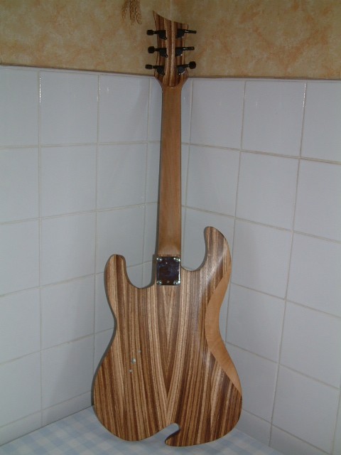

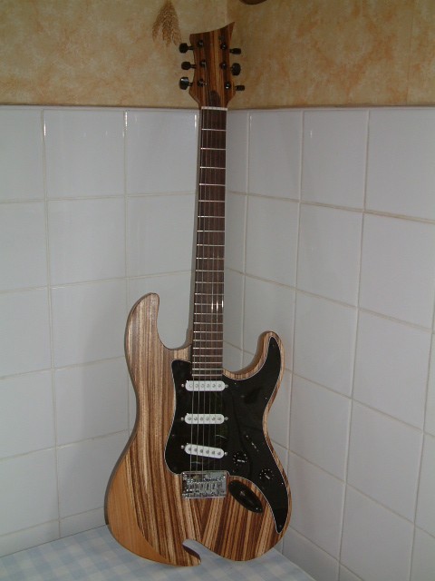

I get asked by my 4 daughters to make them guitars - unfortunately it's all electrics that they want . Well I finally gave in and made one for my youngest - Suzanna (15). She was a very demanding client and it was her design throughout - I just provided the wood and labour
It's based on a strat and used the elctric bits from a 3/4 sized Asian Squier copy that my friend had left over from putting together a "leftie" for his son. Interesting new tricks for me to learn and when in doubt I just treated it as an acoustic
She's called it Orion, and it has some pearl dot inlay on the back and headstock loosely symbolising the constellation Orion's belt. It is a zebrano and lime body (sounds like a drink!) with a Cedar of Lebanon neck (donated by my good friend Russell Rose) and EIR bound fingerboard. Zebrano front and back headstock veneer and black Gotoh tuners. Finish is Tru-oil on body and neck:
I managed to finish it on her birthday and it sounds and plays pretty good.

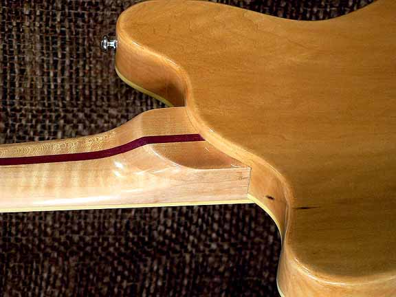

Dave, I've been looking for more pics, but I don;t have very many of electric guitar neck joints. Here's one, this is showing the back of a guitar that has a "PRS" style neck joint. That's become my favorite one to use, I've also used Les Paul type joints. This one basically is simply a tight pocket that is sized to fit the whole width of the neck. A "foot" on the neck that extends under the front pickup allows more gluing room. There's a lot of gluing surface here! I am finishing up another and the neck isn't glued in yet, so I can take a picture for you.
It becomes a little more complicated when you need to put an angle on the neck. That involves a jig that has a angled topside for the router to sit on as you route the neck cavity.
Melvyn Hiscock's Book "build your own electric guitar" is a great book, it'll show you everything you need to know!
