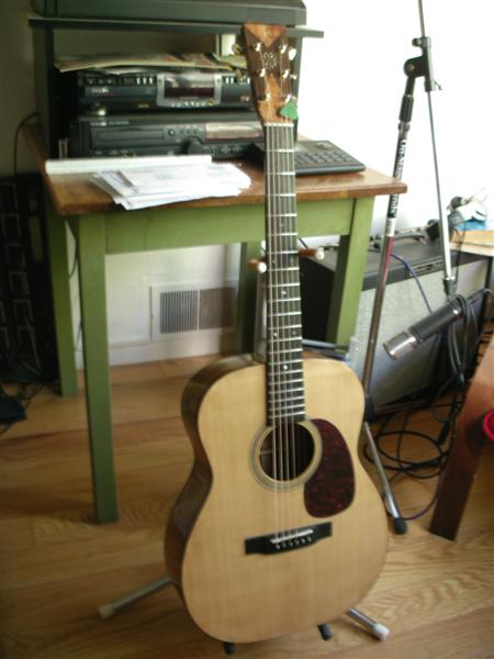

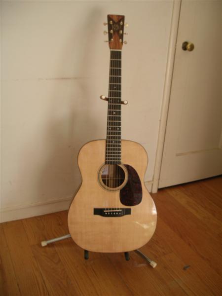

Just thought I'd share a few pictures of #1. It works!
Thanks to all for the advice and support. The blues creek kit was excellent overall, and I learned a lot about what to look out for next time.

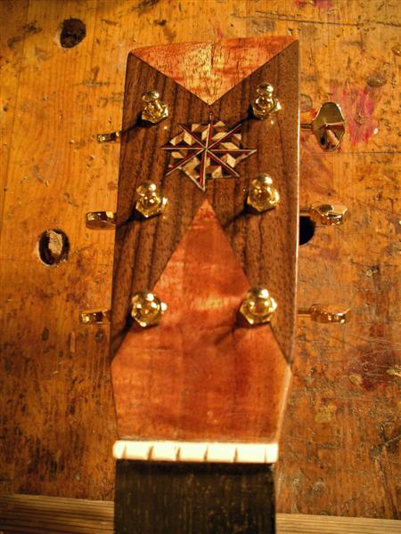

The headstock design was a creative fix for a sloppy attempt at inlaying some abalone I found in Point Arena. I made a medalion ( I guess you'd call it), out of triangular pieces of a wood inlay strip I had bought a while back. Came out pretty good.
I'll always remember that moment when I first heard a string ring out after putting it all together. Truly a miracle.

Hey Nick, nice result! I particularly like your "Medallion". From the pics, it's almost three dimensional. I really like the look, it's more original. And yes, you can get some good stuff from John, he's a good resource to have.

Great job Nick. Looks very good. That heastock a fix? Nahh..., of course not, it was planed that way all the while
   I think that's what I'm learning as I'm going along... It's how you get out of trouble that will define your work... Great stuff.

The headstock is very nice and no mistake (i'd probably not admit it to anyone else) I have been working on designing my headstock, but, I just can't come up with anything. I'd do my name or initial, but, I'm just not sure if I like that. I have a few other ideas...but...I never thought to do a marquetry job like you did...your giving me some ideas...

Nick, congrats -- nice clean work.   Love that headstock -- that must have taken you some time creating the medallion. An adaptation of your medallion could make for a really cool rosette (note to self take a copy of Nick's headstock).

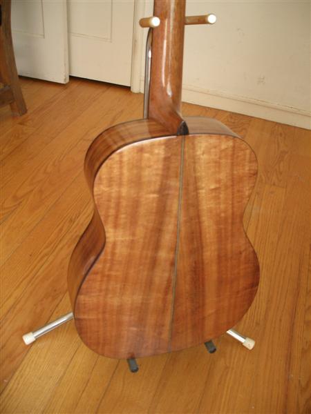

Thanks guys. It took me a while to get back here. The finish is definitely probably an overkill, but I wanted to learn, so I started with a french polish until I decided it wouldn't be as durable as I'd like, and sprayed it with nitro laquer.
This was slow and tedious, as I'm sure it always is. But the results became addictive and rewarding. Many sandings between coats and lots of patience were required. Eventually areas like the back seam became nice and flat. At first I wasn't sure this would happen but persistence payed off.
I also noticed while french polishing that when I messed up an area, trying to fix it would make it worse. When I just kept polishing, the successive coats
would slowly cause a surface defect to dissapear on its own. This ended up being the most important lesson I think. It also generally seemed to hold true for the laquer, where I just kept on with sanding and spraying new coats, rather than concentrating on a particular ding or unevenness.
I hope this isn't too much information. By the way, I am pretty amazed at how good it sounds. I took it to the fifth string here in Berkeley where I showed it to Jim Hyatt, with whom I've talked for years about building this. He gave it the thumbs up. A guy (don't know his name) who went to Oberlin and is an incredible player tried it and really liked it too. It seems to have real nice sustain for this kind of guitar.
