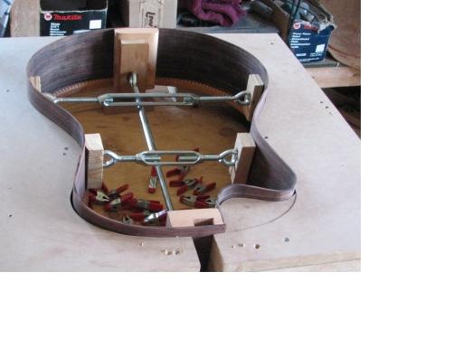

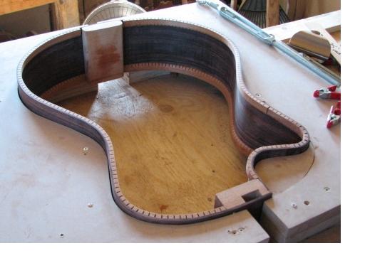

This is how I do mine. Tony's right that it's not really needed on the molds. But I also do my bending forms this way. So I've got half as many bending forms as many people. I'll take some pics tomorrow.
PostPosted: Wed Apr 19, 2006 2:33 pm
Hi there Pady... These are the only pics I had on hand at work... but, you can see I just added the cutaway section to the mold...
Hope this helps. I'll have more detailed pics of just the mold tomorrow... CheersAlain Desforges38827.0588425926
