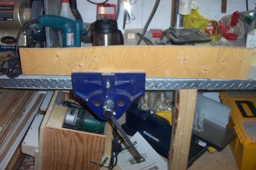

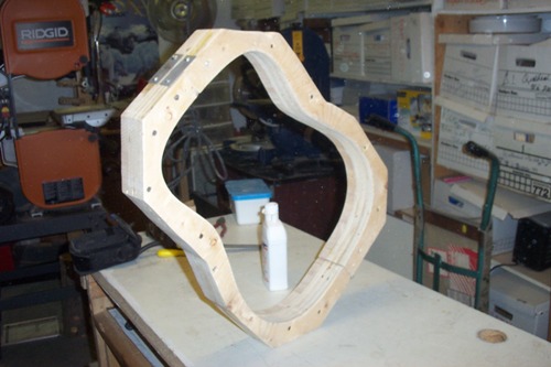

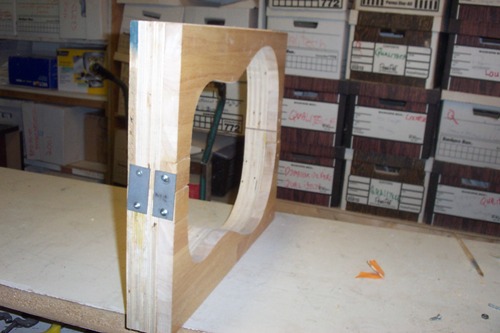

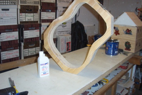

Ok Guys i'm only getting closer to bending some sides but it's looking promissing. since i can only work in that shop of mine so little time during week on evenings and on week ends when i'm not on duty, i managed to steal someone's kitchen table top and build me a mold, my wife wouldn't let go of ours! That carrot thread still haunts me to this day!
Yesterday was just great, i finished my mold and made a side template and some cauls for my spreaders, i'll have to finish them today and if i'm lucky, i should be able to bend some side as well.
Here are some pics, enjoy!
1-2-3 are showing the mold still square on all sides
4- my bandsaw has seen some action!
5-i trimmed all around the mold to make it lighter when i'll be sanding the rims
6-7, some finishing sanding all around
8-9 shellaced the mold and voila
10-11, i was curious to compare my previous molds with the latest and i realized that i seem to be building lighter, don't ask me why!
12-13, made the cauls for the spreaders with the scrap cuts from the mold, a bit of finishing touch has to be done on these
14-end are pics of the side template for my future dread, i used wax paper to transfer the side lines from the plan to the 1/2" plywood board
