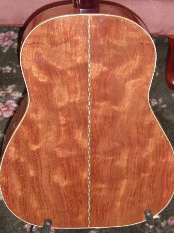

Jim here's one I made. It's a slope shoulder dred.

YES, I got a couple sets of waterfall from Bob. I have a ton of lightly figured stuff too for resawing. It's a great wood. Like LMI says, underrated as a tonewood.
I saw bubinga plain on a hand made electric bass and it got me all excited because it was beautiful. Couldn't find the link quickly. But it is gorgeous under finish. I doubt the non waterfall is difficult to bend as the highly figured stuff.

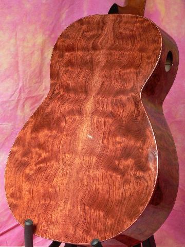

Jim, here's one I've posted before, and bear with me everyone for doing so again.
It's the only Bubinga guitar I've built, and I think it was my best effort. The stuff is an excellent choice for backs and sides.

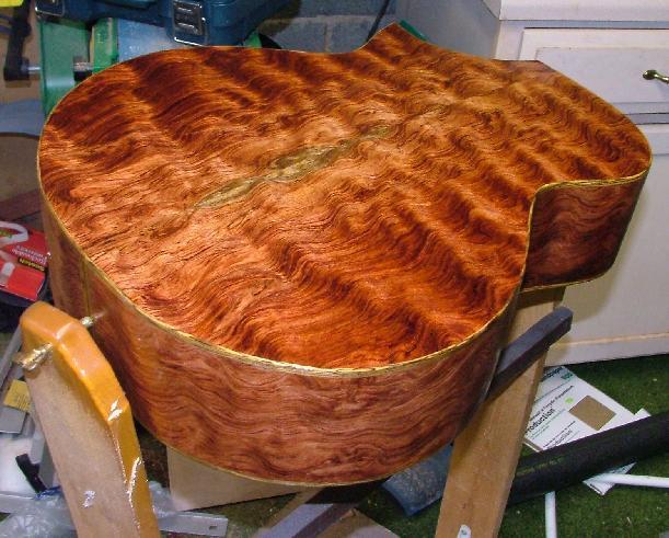

Here's another Bubinga guitar. This one is in progress, having just been coated with epoxy. This set is from Brian Hawkins at Beach Tonewood:

Dave, my knowledge of bending guitar sides is truly vast, and yet thinking back over the years and all of the sides that I have bent, I calculate that exactly half of all the sides I have bent were figured Bubinga. Er, well, I... OK, OK, now the truth: I have bent 2 sets of sides; one set was the figured Bubinga shown in this thread. I used a silicone heating blanket on a solid form, wrapped the Bubinga in wet paper, blue spring steel above and below, very little water, and about 315°F bending temp. When I was done, I thought I had faceting, but it was an optical illusion created by the curls. It came out smooth.
The cutaway portion of the bending form I made was not well thought out, and I had LOT of trouble keeping my cutaway caul in place. That fidgeting caused me to keep the sides in the bender at 315° at least twice as long as I had planned, and I scorched the sides in a couple of spots. It all sanded off. I mention that because I think that's another positive attribute of Bubinga. If it had been Maple or many other species, I think it would have been toast.
