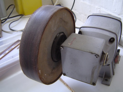

I have almost every variation of sharpening systems known to man. However the most effective and simplest is: Veritas Mk. II jig,about $50: Norton water stones-220-1000 combo and 4000-8000 combo. About $80 each. they are 3" wide, 8" long and will last a long time.For an extra $82 a 320 grit diamond plate keeps them dead flat. Not really cheap, but very good and simple.Since really sharp cutting tools are as important a component in luthiery,it is a relatively small investment. In fact, however, I am one of those lucky people who can get consistent razor edges freehand. I use the jigs and Tormek for restoration of bevel and prepping new stuff.PS-I'm a big believer in secondary or micro bevels.PPS-if you want to send me your two most troublesome chisels,I'll rework them and send them back so you have samples.I know I am not the only person here that can do it right ;just my offer to help.Miketobey38811.3984722222

One of the best things about the Tormek,or for that matter, any very slow grinder is wheel diameter. With the Tormek 10" wheel, you get a very subtle hollow grind which makes for very easy secondary bevels and re-sharpening that doesn't gobble up your tools.Several of the jigs do great things with gouges and "V" tools.Either of them, Tormek, or Veritas jig makes for very consistent bevels. The abrasive isn't so important as the consistency,whether from experience freehand, or from a good jig. The flat honing surface is crucialThere are sharpening projects for which I use only my large Norton diamond plate with lily white arkansas and hard black arkansas bathed in mineral spirits. Waterstones groove and gouge very easily.I've only had my Tormek for a couple of weeks now,but it is a real workhorse. I'm maintaining about 20 planes a few spokeshaves and heaven only knows how many chisels. If I didn't have so much sharpening to do, I might get that first guitar finished. MT PS I finish up with hand or Tormek power strop. Just use care not to round over what you worked so hard to get with the flat abrasives.Also-the pathetic results of tool addiction.I have not yet learned to sharpen saws,but that is next.Miketobey38811.6192476852
