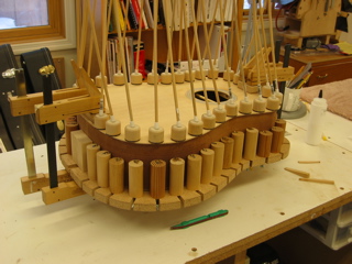

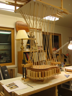

Ross, here are a few more pics of top gluing to sides on the recent OLF SJ 2 Team Built guitar.

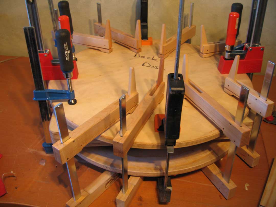

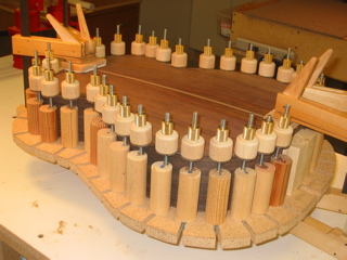

[QUOTE=terken] I used to use speed nuts with half of a spool clamp but the back and
sides had to be very close to actual size for proper clearance. On the last
couple I have used go bars also. I like this the best. I use part of the
spool clamp to protect the top.
This is very cool Terry, i've seen this example a couple of times on the net and it makes perfect sense if you build more than one size guitars,. Is it possible to buy the spool clamps at any hardware store or i should look at a more specialized woodworking store like Lee Valley for instance?
