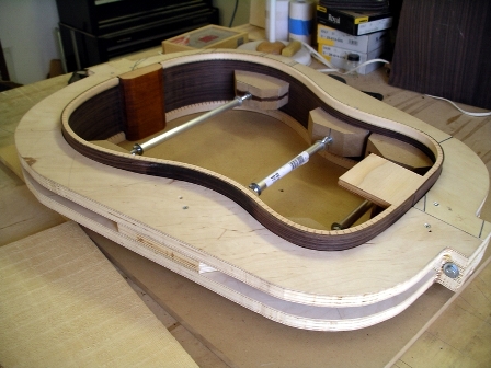

is guitar #2. It's a dreadnaught in EIR from Colonial Tonewoods and Lutz spruce from High Mountain Tonewood. I got the rims together and the back is in progress:
Binding will be flamed maple I got from RC Tonewoods. I also got some of his 'mahog-a-lam' purfling that will go into the top. Here I am gluing some b/w purfling onto the edge of the binding:

Ross,
I don't know if its the norm or not. I know that for the purfling between the binding and the top I can just route a ledge and glue the purfling in before the binding.
I wanted contrasting lines between the binding and the sides. It seemed like gluing the purfling and binding together and bending/installing them together would be easier. I am worried about heat releasing the glue when I bend them. I'll find out this weekend .

Gluing the purflings so that they are on the side? Yes that works fine. I've done that with maple purfling lines glued onto EIR bindings. No delamination anywhere, after 3 guitars worth done.

I think one of the later Titebonds, I think the Titebond II, exhibits great heat resistance... Or was that Titebond III???... hmmm...
PostPosted: Wed Apr 05, 2006 6:43 am
Posts: 785
Titebond II is the right glue for this job. (It's pretty much the only job for which Titebond II is the right glue.)
