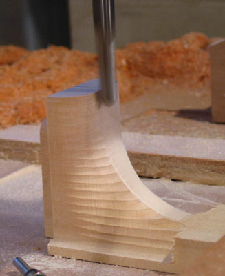

I'm new here, but not to luthiery. I am fascinated by CNC and built my own machine. Currently I am tweaking a program to carve necks. Is there anyone else doing anything like this? I don't have 3D CAD knowledge, so I'm using 2D and adjusting the G code. I'd be happy to share what I know so far. I hope the pic comes through.

There are several people here doing all levels of CNC. To my knowledge, I'm the only one cutting necks for other people right now, but I could be wrong.
Tell us a little about your machine, Marty. Size, speed, frame, style?

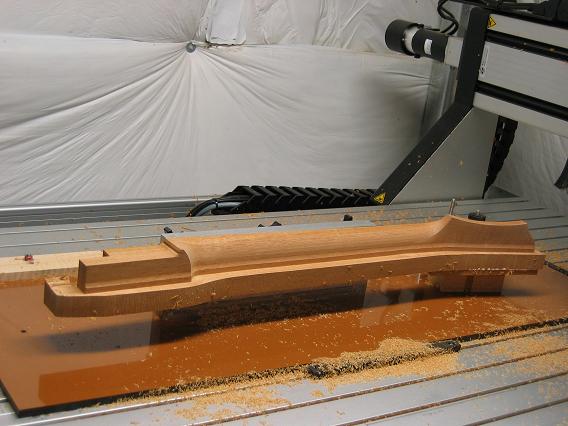

One good CNC neck pic deserves another, right?

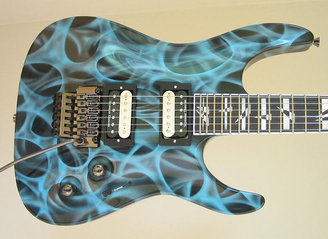

Speaking of John Watkins, guitars and necks,
Today my A'hem "Watkins Shredder" named the Blue Monster! made its debut at church.
Aside from the kids drooling on it, I say kids lightly, there 16 to 20 year old guys, It all went great!
I think one of the things I like best about this design is the way the neck fits the palm of my hand above the 12th fret, up were the neck meets the body, its effortless to play up there. Unlike my bold on neck Charvel, which is, well, blocky.
It sounds as great as it looks!
Thanks again John!

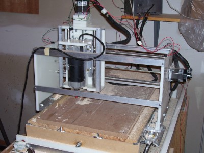

Here is Version #1 of my own design. I had first made one of John kleinbauer's Pipe Dreams to get my feet wet. I wanted something that wouldn't really expand and contract in my basement. Most parts are of HDPE and Aluminum and drill rod. It utilizes skate bearings except for the Z axis where I also used Stew Mac pattern router bearings. It has a 14x24 X and Y area. The Z is capable of routing a carved LP body blank which was the basis for the thing in the first place. I recently crashed and decided to use some limit switches for the first time. I haven't even soldered them yet or make them tidy. I kind of blended the Cheap CNC machine concept with my own ideas of how this thing should work based on my Pipe Dream experience. By the way, I think John's plans are a great bargain and would recommend them as a great place to start.
     Since I have limited electronics experience I went with a pre-made controller. It is a Maxnc closed loop system. I have a small Maxnc mill at work, and got familiar with it so I decided to use their system here. I am pleased with their products.
     I plan on extending my Y axis to about 48 inches soon if I can get the drill rod and threaded rod easily. I get about 50-60 in. per min max, which has been fine. The trim router is a Porter Cable which has been decent as well.
I use an old version of ACad and Version 20 of Bobcad to the best of my abilities:-).Marty M.38809.6747685185

Here is the picture.

Nice machine Marty! I' like you I built my own machine to make parts, jigs, ect. I'm now trying to learn cad.

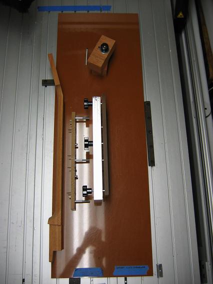

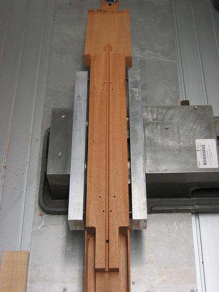

I'll add a couple of fixturing ideas I adapted from Dana's article in American Lutherie 76:
3 sided is a lot more work and hassle than 2 sided but the only way to get all the angles on the tenon.

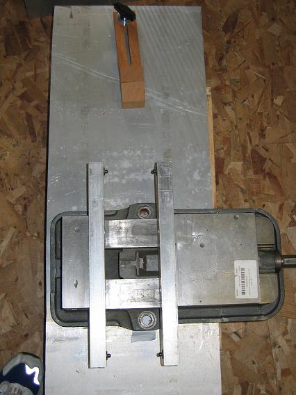

Rand, can you talk a bit about your setup? For example, why is the one fixture in a Kurt vise and the other mounted to phenolic?

John - I use two separate setups because my machine's work envelope is only 21x39". The fixture with the Kurt vise is for all the up-facing operations including the FB gluing surface and headstock face. Index holes are drilled for dowel pins to attach the blank to the "carrier" for the side fixture and later for FB positioning. The carrier attaches to the blank with screws and is bolted to the center block. I've seen similar factory setups that use vacuum which would be better.
Here's a pic of each fixture let me know if you want more info.
