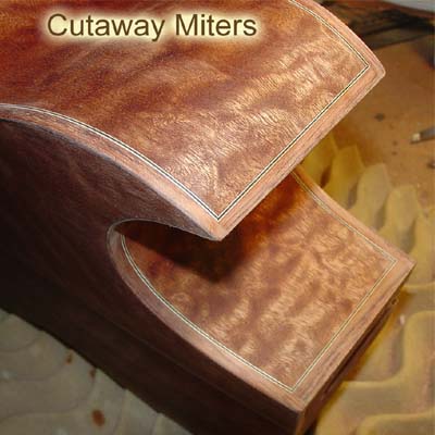

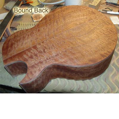

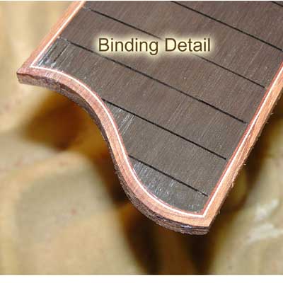

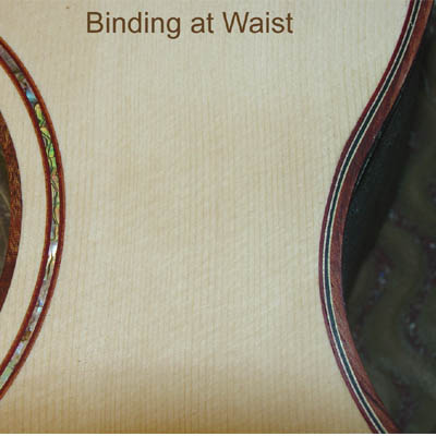

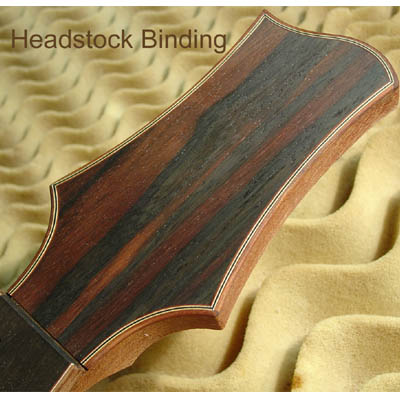

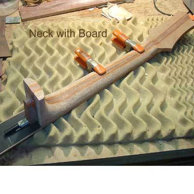

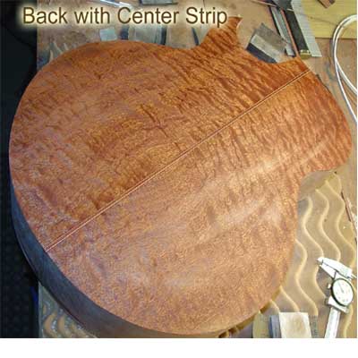

    I've been picking away at the guitar for the trip to Africa in July along with some of my ordered guitars. I have stayed up overnight a few times just to dedicate some time to it in order to have it ready in time to use ahead of the trip and to pique interest in its upcoming auction.
   I'm sure you'll all agree that the true beauty of all of the woods donated by the fine folks here at the OLF are starting to show more of their potential. This is going to be a beautiful guitar and its tap tone that becomes much more evident after binding locks all of the edges together is strong, responsive and very loud.
    Here are a few photos of recent work on it. It has progressed quite a bit since these were taken and I'll post more pics soon.
   If you look closely, you'll notice that I've maintained a thin line of Bloodwood throughout the binding and purfling scheme for obvious symbolism.
   I'm beginning to think about inlay ideas so if anyone has any, please share them with me. I'm leaning toward more of a simple and understated/elegant scheme with a mixture of wood and shell for the inlay. I have loads of small wood pieces that will work great and offer vivid and warm colors and textures to anything I decide on. Purpleheart, Pink Ivory, Bloodwood, Kiatt, Ugandan Cypress among others will provide a broad palette of hues to select from so it's just a matter of locking in a design.

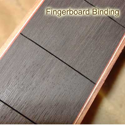

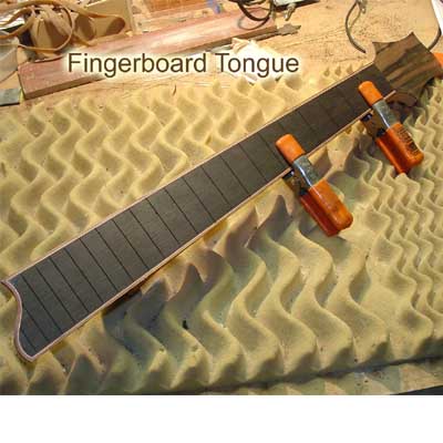

That binding really sets it off. Do you bind the ends of all your fretboards?

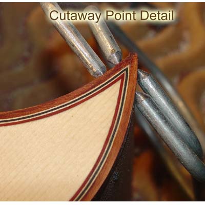

Very nice work Kevin. If you don't mind, what are the little pencil looking things in the cutaway point picture?

I am with John How... what are those points on the cutaway... I presume a clamp of some kind?

[QUOTE=Brock Poling]
... what are those points on the cutaway... I presume a clamp of some kind?[/QUOTE]
They look like spring/c-clamps. You can see how they circle around from point-to-point.

   Thanks guys! Those points on the binding at the cutaway point are spring clamps. In that photo, the binding and purflings weren't glued yet. I had just cut the miters and was clamping for a dry fit before gluing.
   I make those clamps from various sizes of round stock to provide different tensions and pressures on small areas that can be stubborn like those ends of the binding on a Florentine Cutaway point.
   With wood bindings, I always LMI white glue. I've always been of the belief that the corners where interfaces between the sides and plates are formed are critical to the resonance and sustain of any body. The glue from LMI dries very hard and contributes to the integrity of the joints because it does. With any of the plastic bindings, I use DUCO or similar style cement. These glues actually melt the surface of the bindings that they come in contact with and create a very tight fusion between them and the woods that they are being joined with.
   Using the acetone based cements causes the bindings to become very hard after drying, too. This creates that same tight integration between the sides, top and back that is conducive to optimal vibration transfer.
