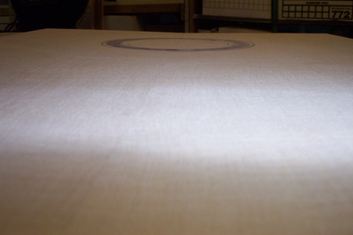

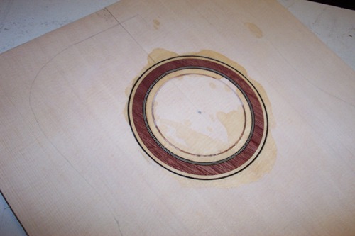

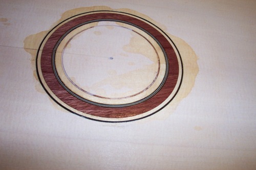

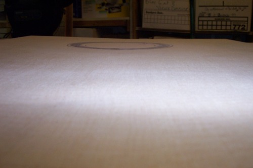

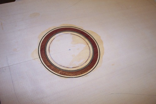

Good evening folks, here's my rosette sanded down and levelled, then shellacked for the pics, Please Bear(())with me, lots if piccys

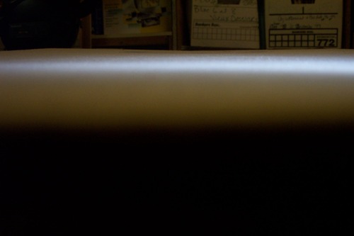

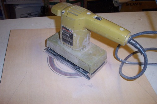

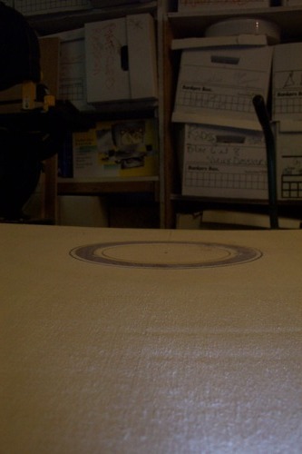

I had to use my this finishing sander for that delicate part, my top plates were too curved upwards at each end to be able to use my drum sander, i would have had to put presure on the plates with both hands and feed 'em forward on the table, wasn't comfortable enough to do it that way so i used my old tool instead!
Thanks for watching!

Serge, that looks really really nice. The shellac sure popped the figure of your rosette.
I wonder if double side taping your top to flat piece of MDF would have kept it flat enough to run through your thickness sander. How much were the ends curling up?
Are you still going with the deep cutaway?

Looks good Serge, Hey cool avatar bear

Way to go Serge!!!! Looks like you are off to the races!

Really nice Serge!

Anthony, i'm just hitting my forehead with the computer screen! Why on earth didn't i think of that duh tchah! i 'll have to write this down in my notebook, happy it turned out ok though! Thanks for the tip bro!
EDIT : Sorry Anthony, i must have been too excited and did not see your question, no, i'm gonna go with a full dread plan on this one!Serge Poirier38810.9789351852

You rockin bear you. That is one nice rosette.
Love the rocking bear too.

Looking good, Serge. I've got a feeling this second guitar will be a good one.

Looks nice, Serge. Now you`re cookin` with gas, or is that the mexican food you`re eatin`?

Serge, that is a beautiful rosette. You should be proud, my brother from another mother.
