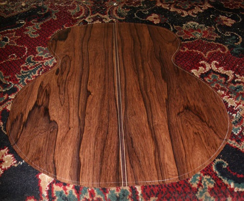

Not to jump Old Man's thread...But, I'm a big fan of Mad Rose.. I like it more so than BRW. I recently picked up 2 sets, both from different sponsors here on the OLF. Besides, I think Serge wants to see some...
Although laid out w/ a Dread shape, one will be an OM, and the other, a 0000 sized guitar.
This is from bchtonewood:
From AC Woods:
I fell for its' looks awhile back, and when CFM came out w/ a Mad Rose L Juber model...I caved in and got one!

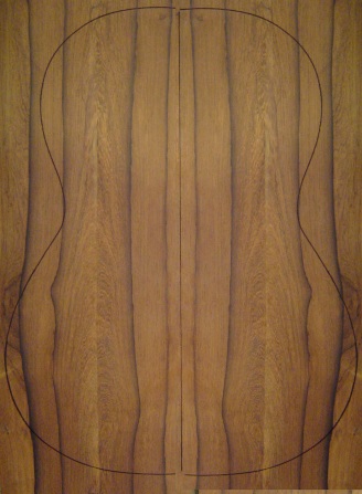

Here is another picture of some madrose just to show you the different looks it can have.
On the question of Brazilian v Madrose, they have a very similiar density (Source Colins testing, thanks Colin) and many people say Mad Rose is as close to Brazilian as you can get tonewise, I have never made a brazilian guitar so can't qualify this one from a personal prespective.
Price wise Madrose is cheaper, as it is not in such short supply, but is still more expensive than EIR.
I believe it is not that easy to find in big widths, which is one of the reasons it costs more.
Another Rosewood which is easy to over look, is EIR. I know it is pretty common but it is still a very good tonewood.
